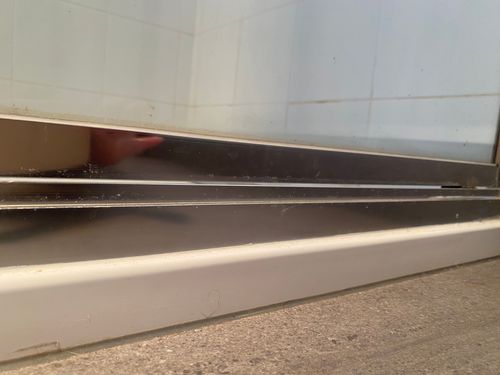

When we shower, water runs down the door and leaks out through the gap shown in picture 2. We’ve tried using a generic shower seal, but because it’s a framed door, we need a seal that’s at least 15mm wide — and we haven’t been able to find one that size.
The underside of the door isn’t solid either, shown in the first picture, so we’re not sure if something is supposed to slide in there, or if a part is missing.

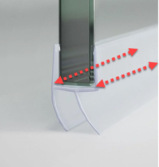

The channel on the underside of the aluminium frame may be there to accept a proprietary seal. If you could identify the brand of shower frame, you may be able to find a replacement seal that works perfectly with your shower door.
Alternatively, the best option I can think of is to use clear silicone to stick a Sandleford 10 x 2200mm Shower Seal Strip inside the channel on the underside of the frame.
If need be, you can cut off the pieces I have indicated below so you can get better contact with the underside of the aluminium frame.
