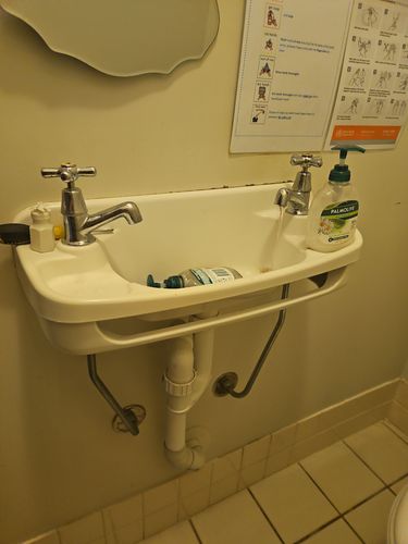

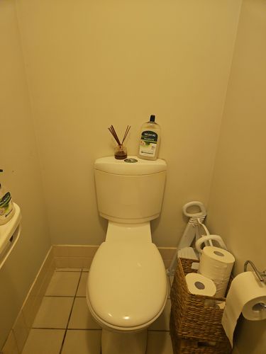

I need to replace my powder vanity as the plastic has a crack in it. I figured I may as well update it all whilst I'm at it. I want to do most it on my own besides the plumbing. My plan is to also install easycraft panels on two side walls, paint and replace the toilet. I've started with some research but want to gain further knowledge from those in the know and who have DIY experience. I'm hoping to do the project over 6 days.
This is my plan along with any questions I still have or seeking advise on which direction to go.

Hi @Raelisa6,
The first thing I'll say is well done with the planning so far. You have certainly put a lot of thought into it, and the sequence of events is logical, and the timeframe is not unreasonable. The next thing I'll say, speaking from experience, is to never expect everything to go to plan. There's a reason you always hear about construction projects going over time and over budget, and it is because things never truly go exactly to plan. Don't become disheartened if things don't go as smoothly as you'd hope; there are always unexpected things that come up, and it is just part of the process.
When it comes to plumbing, my suggestion would be to contact a plumber and have them come out to quote on the entire job, including the removal of the existing fittings as well as the supply and installation of the new ones. There are a few reasons for this.
The first is that your basin is hard plumbed with no isolation valves, which means once those taps come off, there is nothing to stop the water from flowing out of them. If you are hoping to use water anywhere else in your house over the course of the project, these pipes will need to be capped, which is something you will need the assistance of a plumber with.
The second reason you should have a plumber come in at the start of the job is that it is extremely unlikely that your new plumbing fixtures will line up perfectly with the existing pipework. It is going to be much easier if they are involved in the removal of the old, as they will have an idea of what alterations will need to be made when they go to install the new fixtures and can be prepared based on this prior knowledge. They can also give you guidance on what you can do while sheeting the walls to make their job as easy as possible.
The easiest way to go about getting your new plumbing fixtures is to have the plumber do it for you. If they know what they are installing before installing it, they will be able to prepare accordingly. There's also a good chance they can get them for cheaper than you can.
I completely understand that plumbers are expensive and you are trying to reduce the amount of work they will need to do, but from experience, having done a lot of sheeting work around plumbers, if you aren't on the same page, there's a good chance you will be working against each other. This usually means you will both have to do extra work, which in their case will result in a higher bill. The easiest way to ensure you are on the same page is to speak with them, ask questions and listen to their advice. If you frame your questions around how you can make their job as easy as possible, they will definitely appreciate it, and it will make both of your lives easier.
Looking at the overall plan, everything else looks good and is in a logical order.
In terms of tools, I've had a good look and only have two things to note: the first is that the plumber will be doing all the plumbing work, so don't worry about getting any of these things if you don't already have them; the plumber will have them. The other thing is that a hole saw set is going to be worth grabbing, as it will give you the cleanest circular cutouts in your VJ sheeting for pipework possible.
Allow me to tag our experienced members @Dave-1, @Nailbag and @Noyade to see if they have anything to note or thoughts that they can share.
Please let me know what you think and if you have further questions, please don't hesitate to ask.
