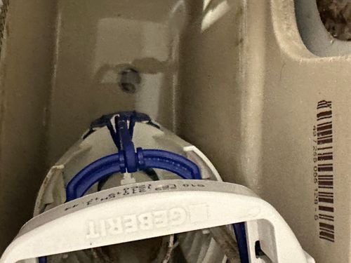

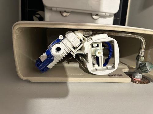

I have a Villeroy and Bosch cistern that is leaking water into the toilet bowl. The cistern internals are Geberit. I suspect that the washer is the problem and I want to replace it. I don’t know how to remove the internals to replace the washer. I have attached photos of the internals of the cistern. Any help would be greatly appreciated. Thanks Jeff Travers

I recommend you have a quick read through this guide on How to fix a leaking toilet. A faulty inlet valve or a faulty outlet valve can cause water leaking into the bowl. The guide will show you how to determine which one it is.
I presume that to remove your outlet valve, you would first need to remove the inlet valve from the side of it by unclipping it. Once removed, that will allow the outlet valve to quarter turn anti-clockwise, releasing the locking tabs. If it won't turn, there might be other types of clips that need to be released lower down, allowing you to pull the outlet valve directly out.
