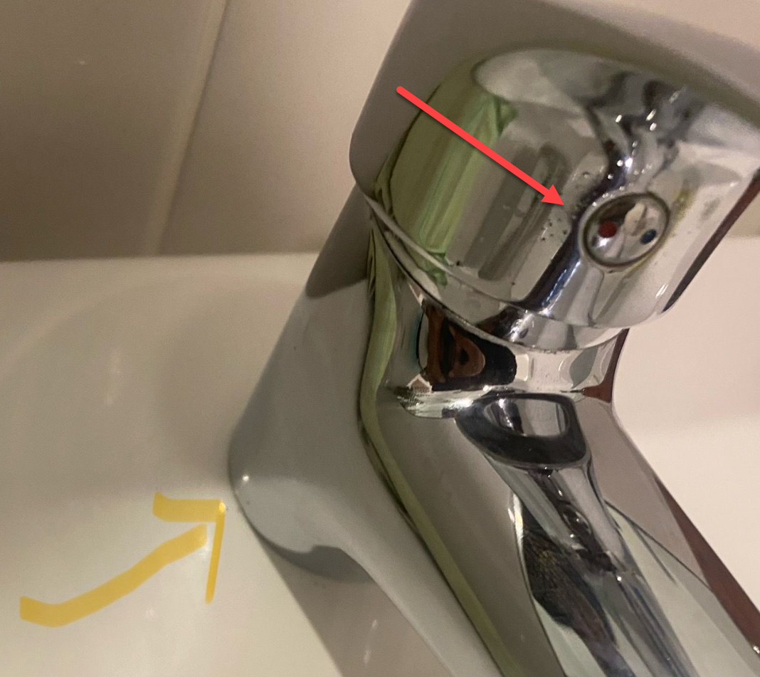

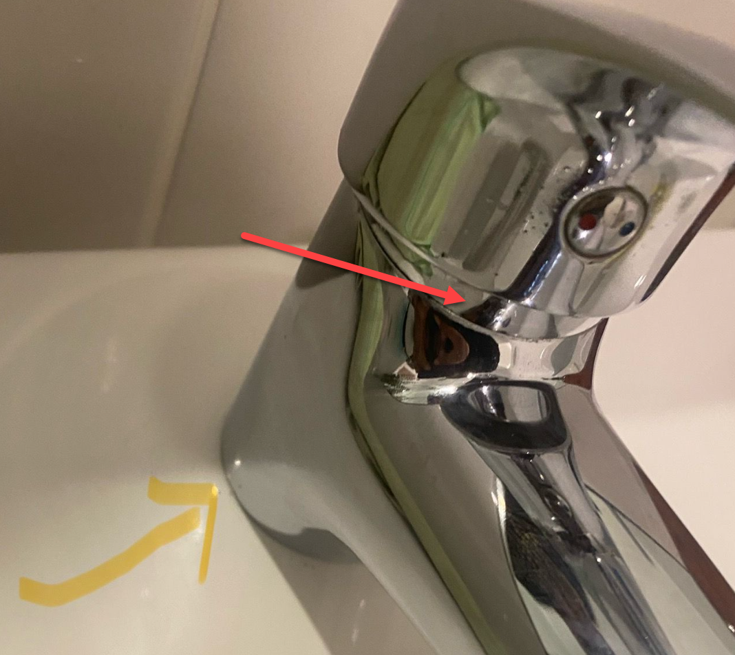

I hope everyone doing great. My bathroom sink tape is leaking from the base. Any ideas how to fix it. Try to reattach it again but still leaking a bit.

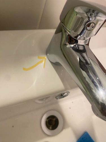

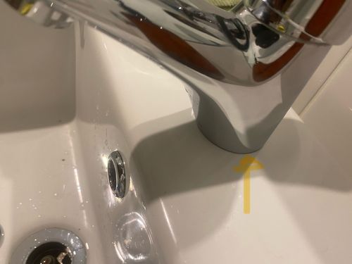

sorry I didn’t explain it well previously. actually it’s not the Tap that is leaking .it’s more like when some water goes around the base of tap, while washing hands. That water comes down into the cabinet from the base of the tap where it’s sitting over the sink. I hope I explain it bit better now. Thanks

Well, if that is the case, the solution is much simpler. Take some Parfix Clear Bathroom And Kitchen Silicone and run a bead of silicone around the base of the tap.
Check out How To Silicone a Gap for some guidance on the process.
