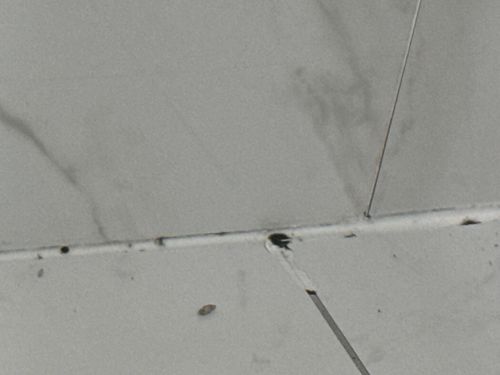

we have replaced the silicon around the base of our shower three times! Each time we have done everything correctly including using the proper shower silicon but it still seems to get mould stuck in it and can’t be removed. Someone mentioned that we could use some sort of grout instead? We would like to give this a try but not sure what to get?

My apologies for the late reply. I suspect that you have a deep-seated mould infestation which is causing the mould to travel up to your new silicone seal. The next time you remove your silicone seal, I suggest removing as much as possible and spraying the area with Glitz 2L Cleaning Vinegar. Vinegar's acetic acid content helps kill mould spores and prevent further growth. While it may not be as effective on porous surfaces, it's a natural, non-toxic option for tackling mould in many situations.

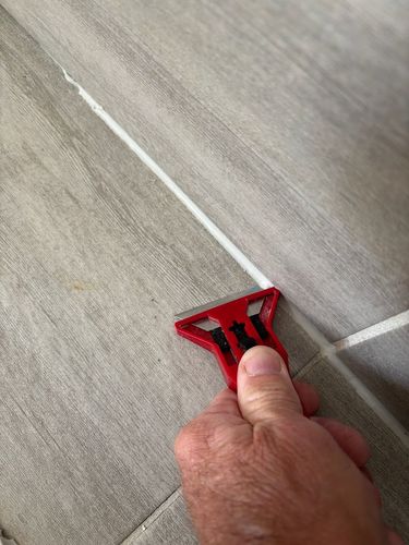

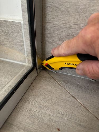

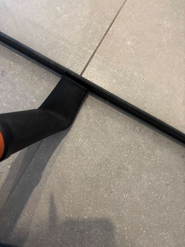

  • I remove all the silicone using one of these tools pushing it forward. Ignore the crap reviews as they are probably not using it correctly. I also use a new blade in my scraper. Again ignore the reviews.
