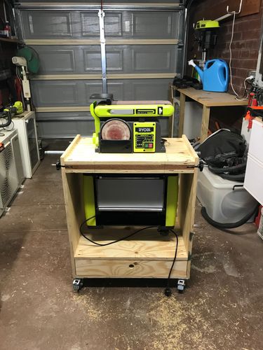

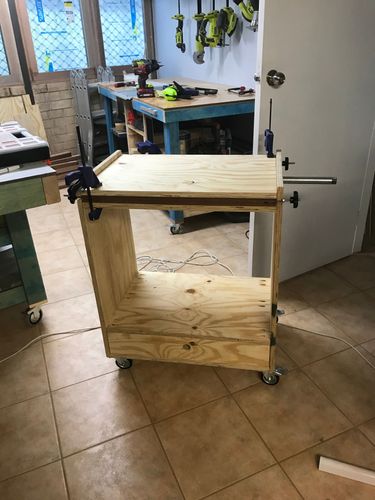

So I’ve been running out of space in my garage/workshop so I built a couple of mobile stands to house our Ryobi tools.
Fliptop tool stand holds the belt/disc sander and the thicknesser.
Folding wing mitre table for my Ryobi Dual Bevel Mitre Saw.
Super happy with how they both work!

That's a super interesting way to house your machines, would you mind telling us more about how you created the flip-top mechanism. You've certainly got some fantastic woodworking skills, and I'm really impressed with the design you've come up.

It pivots on a piece of 20mm galvanised pipe housed between two side supports and locks in using eyebolts and hex head bolts!

Reminds me of the Elu/Black and Decker flip drop saw and table saw concept.
What's the weight of the Ryobi thicknesser?
I'm sure it's well secured. 😉
Re: fliptop tool stand
It weighs 30kgs and yes it secured with 4 HD bolts!
