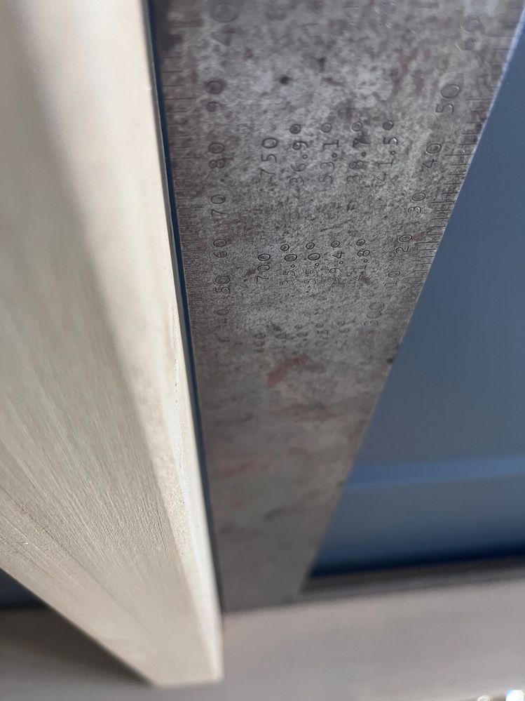

We’re having trouble assembling our gazebo, at the point of putting the roofing on. We can’t align the iron against both the ridge and the roof trusses, on the second side - the first went together nicely. There’s almost 2 cm gap between one top corner of the iron and the roof rafter when the iron is lined up with the truss. If we instead align to the ridge then the bottom corner hole ends out in space, past the side rafter, so it can’t be screwed down.
Does anyone have tips on how to nudge the alignments into square, please?IMG_2629.jpeg

Hi Mitchell. Thanks for answering. I’ve been over the diagonals and the distances between posts, and they’re all within a couple of mm.

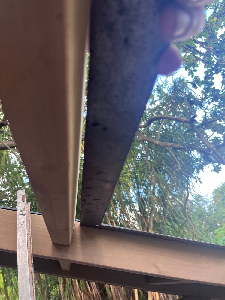

As I said, the first side went together nicely. The rafters are square to the trusses (pic 1), so the roof iron lines up with the trusses and the rafters.
However, on the other side, the rafters are not square to the trusses (pic 2) with a half inch gap between my builders square where there should be maybe 1-2mm at most. If one side of the truss is square, surely the other half should be too?IMG_3815.jpegIMG_3817.jpegagonals are equal.

😕 What a pain. Id say the frame is out of square most probarly. Ive had the same thing happen to me when I was building my gazebo and I would have sworn that  I had everything square.

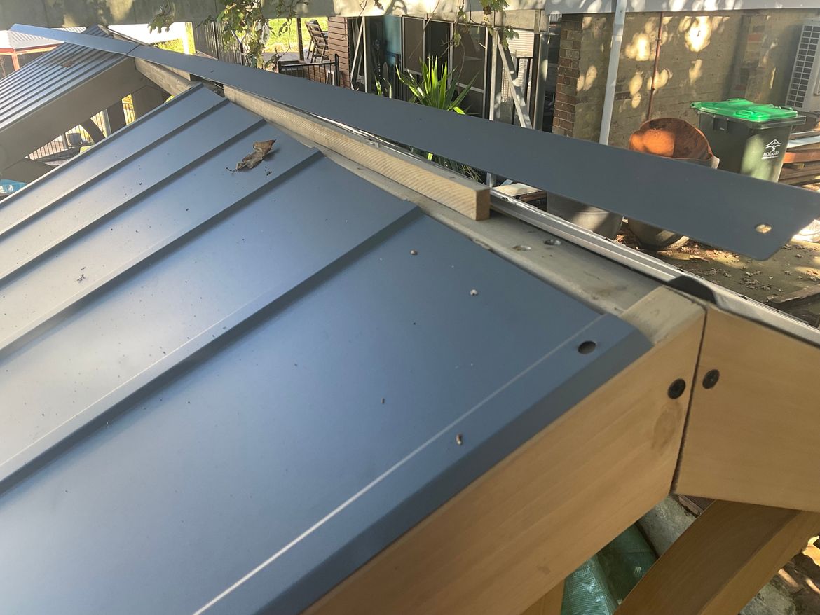

You can see the tin on the roof not following the straight ridge is why I am thinking this (Your first photo) You have lined up the tin with one edge and as you continue across it wants to go higher. I fixed mine by removing and re-attaching the tin at a better angle and then used the right angle trim (along the roof edeg and wall) to "hide" my mistake as it goes over the roof and also down the wall a little.
If your walls are out of true and cannot be straightened then my suggestion would be to "fix" the trusses/ roof suppost so they are square. If you force them into place that presure will warp things overtime. Far better to add a piece of timber to teh sides/trim a piece to make things line up if you get my drift.

If you have a wider ridgecap it could get you out of trouble. The bottom of the roofline may not be so straight is all. The wider ridgecap would cover the gap at the top.

We have only the ridgecap that came with the kit. What can Bunnings supply that would suit the cabana? Can Bunnings supply replacement roofing at no cost to us, since we can’t get one half to fit straight while the other fits? I’ve measured the rafter angles at 88º instead of 90º, so they’re not sitting square to line up.

Is the surface the gazebo is going on perfectly level?
This gap makes me think it's possible the post at the bottom right of this photo might be elevated from the rest. If this was the case, the posts can appear square, but they are pushing everything above out of square.
Would it also be possible to get a photo siting directly down the ridge beam? If this is not perfectly straight, it may also shed some light.
