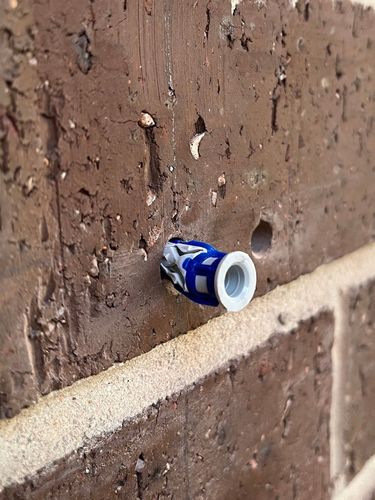

Hi @Nailbag,
So i've gotten underway and ran into a little issue – after drilling the holes with the 8mm drill, I'm trying to hammer the Ramset anchors in, but they start bending after getting the first 2/3rds in. Do you have any advice for getting the anchors in properly? Thanks.

Re: How to attach folding table to brick wall?
You simply haven't drill the holes deep enough @CROBBO
Use pliers to twist it back out then re-drill deeper and blow out the debris. A piece of tape on your drill bit will help you know when you're at depth. You can actually go as deep as you like, just not shorter obviously.
Once the anchor is in all the way you can use a chisel to slice the anchors end lip off so your brackets sit flush to the brick.
