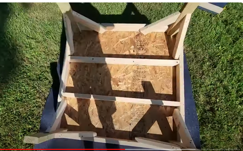

I am trying to build a simple and strong low profile stage. final area would be something like 2.4m x 2.4m So far I am thinking something similar to https://www.youtube.com/watch?v=p2UETDqA7Rg
4 small modules then assemble them together. The stage would be outside, the floor is pretty flat though there might be some slight adjustment to make sure all the post are levelled.
What type of wood and timber would you recommend and screws for such a project. Any brackets? Anything for the legs that could be used as leveller?

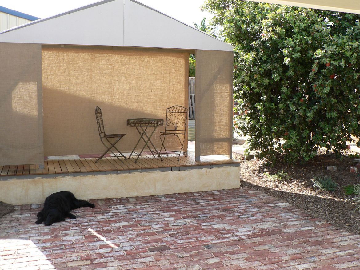

(I have a stage in my backyard. It sits on a brick surround and is constructed of Jarrah, which is weather-resistant hardwood - because I had pulled down an old Jarrah-framed shed, so I had some at hand. Mine is also covered in painted hessian, which lasts about 10years before needing a re-wrap. Photo included - before painting the hessian to stop it rotting. And a bonus bored dog. The floor height was chosen at 600 as this is then also OK as a seat for guests which is its most used function.)
