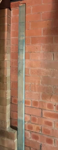

It is possible to use untreated framing, although you would be exposed to damage from things like termites and borers. Typically, you would use H2-treated framing for indoor applications like this. They are treated against insects like termites and borers. This 70 x 35mm Framing MGP10 H2 Blue Pine would be a good option. If you did use untreated timber, you would need to be aware that you are at increased risk from termites and boring insects.
It's typically better to have a slight gap between the timber and the brick to allow for ventilation; however, there is no hard requirement for this. You can create a slight ventilation gap by simply sticking some window packers to the back of the frame when standing it in place.
I have built a similar wall and simply lined the back side of the timber with plascourse to prevent direct contact between the timber and the brick, as if this is not a double brick wall with a cavity, there is the potential for condensation to form on the back of the timber. The plascourse creates a barrier to prevent this condensation from forming on the timber.
To attach timber to the brick, you would typically use fixings such as these Ramset 10 x 75mm Galvanised DynaBolt Hex Nut Bolt
So, to summarise, start by investigating the ventilation requirements around the electrical systems as they are the most important variable. If you can confirm there is suitable space to build the frame, then preferably use H2 treated timber with a slight separation from the wall. The frame can then be attached to the wall with Dynabolts.
