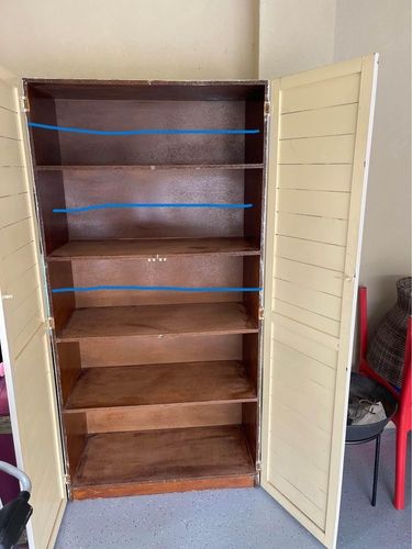

Thanks Grame,
I just need to add the 3 x shelves (marked in blue)

I propose going to the store and looking at the sizes of the MDF and Plywood panels. Since you have your shelf measurements, you'll be able to estimate how many shelves you can make out of a single sheet of timber. I suggest not getting anything less than 12mm in thickness, because if the timber is too thin it will slowly start to bow inside your cabinet.
The shop saws are capable of cutting down the large sheets to manageable sizes for transportation. Unfortunately, they are not made for precision cutting. I recommend cutting it at home with either a hand saw or a circular saw. I suggest using the Taskmaster 6mm Pin Nickel Plated Metal Shelf Supports as a way to hold the shelf in place.
The advantage of cutting it a home is that you can measure to a high degree of accuracy where you need to cut the timber panel. You'll be confident that the timber will neither be too big or too small. Having second thoughts about cutting it straight? I suggest doing several practice cuts with a hand saw and some off cut timber panels. Doing the practice cuts will give you a very good idea of how a hand saw works.
