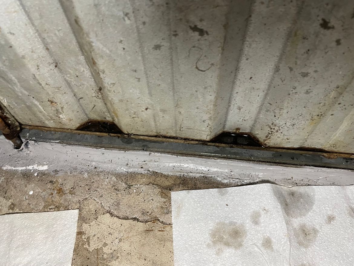

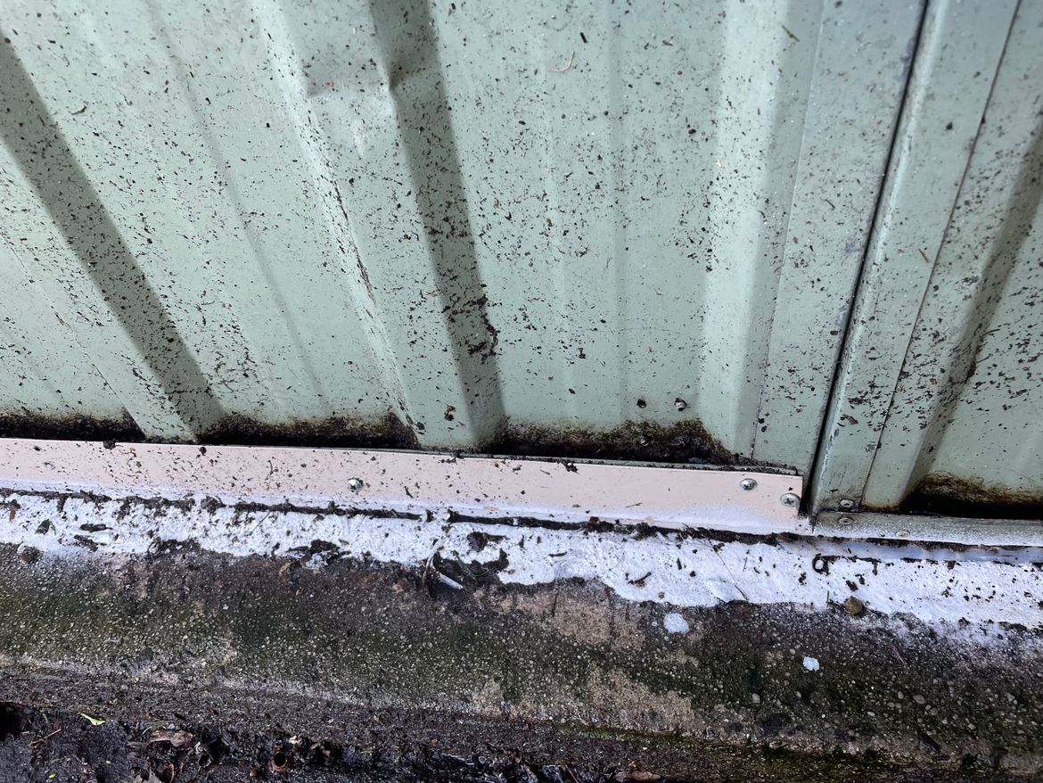

@EricL @MitchellMc Working away with your suggestions, the leaks from the side panels have stopped. Tested with the rains :smile:
Now the shed doors are showing similar leaks, that is the channels collect water on the inside and starts pouring inside when it rains hard. See pics. How do i drain this?
Also there is a gap at the below the doors, Should i put a rubber seal ? inside of the shed door where it pours out of the channelinside of the shed door where it pours out of the channeloutside of the shed dooroutside of the shed door

Hello @Sath
I believe that the moss and mould collecting in the channel has created a seal between the drain channels. This in turn now prevents water from draining out. I suggest washing the channels with 30 Seconds 1L Outdoor Cleaner Spray. Wash the door channel vigorously with your garden hose.
Once the channel has opened up, I suggest drilling a drain point on the door just as you did on the side channels of your shed. This should prevent water from gathering in it.
In regards to the rubber seal, I suggest having a look at the Moroday Rubber Seals in the store and see which one suits your needs.
