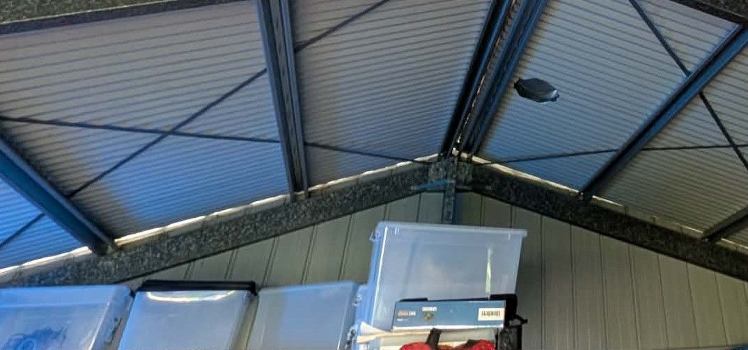

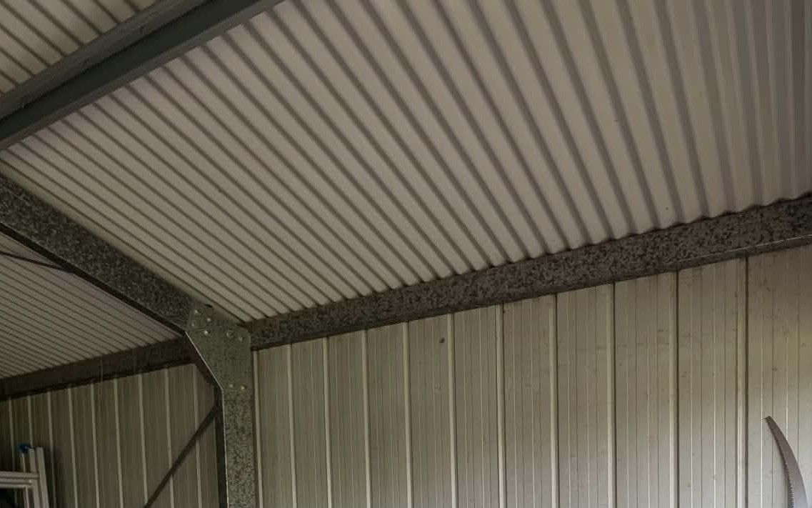

Team, here are a few photos of a newly installed Garage Shed. I need some advice on how best i can seal the following.
#1. Gaps where Roof and Walls meet. [Photo 1 & 2]

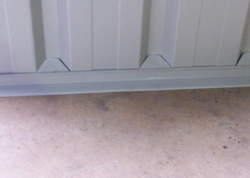

#2. Gaps where Floor and Walls meet. [Photo 3]
You can see in one of the photos that some water has already come in from Yesterday's Rain.
I am planning to use expanding foam for #2 above. Would that be a good idea. Should i choose a Gap filler rod+ Sealant instead?
The Gaps described in #1 above are pretty big and i am worried that expanding foam may not be a good option.

I wouldn't advise using expanding foam as it is not designed to get wet.
For the gap between the roof and wall, I would suggest you use Suntuf Black Greca Foam Infill and Sika 300ml Grey Sikaflex 11FC Plus Polyurethane Adhesive Sealant. You may need to remove the screws from the roof sheet to get the foam into place before rescrewing. The foam would only act as a backing for the Sika 11FC which will have to coat it entirely if you are looking to create a waterproof seal.
I would then seal the wall sheets using the same Sika 11FC. Run a bead along the outside where the wall sheets meet the concrete to prevent any water getting in underneath the sheets.
Please note that Sika 11FC is extremely sticky so you should keep a bucket of water and some clean rags nearby while carrying out this project. I would also advise using old clothes that you can bear to lose.
If you have any further questions, please don't hesitate to ask.

Welcome to the Bunnings Workshop community @Taf. It's terrific to have you join us, and many thanks for your question about filling gaps.
What Jacob was most likely referring to with the Sika 11FC is its use in areas where water is actually pooling on the floor and trying to push its way into the shed. In your situation with the gable end and the roof edges, I don’t think he was suggesting that the Sika be used along those roofing sheets.
For your project, the foam strips themselves are designed to block debris and prevent water from being blown back up under the sheets. I would start by carefully pushing the foam into the gaps along the gable and sides where the gutters are already installed. That alone should stop the majority of dust, leaves, and wind-driven water from entering.
If, after installing the foam, you still notice leaks or water ingress, you could consider applying SikaFlex on top of the foam to seal it. This would involve spreading it across the foam and smoothing it with a spatula, but it can be quite tricky in pre-built sheds, especially with gutters in place making access difficult. For most sheds, properly fitted foam strips are sufficient, and if not, it indicates that there is missing flashing on the exterior of the shed in those areas.

I would not use anything to fill any of the gaps because the shed needs to breath.
Use capping on the roof and the floor needs special attention.
The bottom edge of a colorbond (so similar) sheet is not protected so it's important to keep that clear of everything - leaves, debris & soil.
