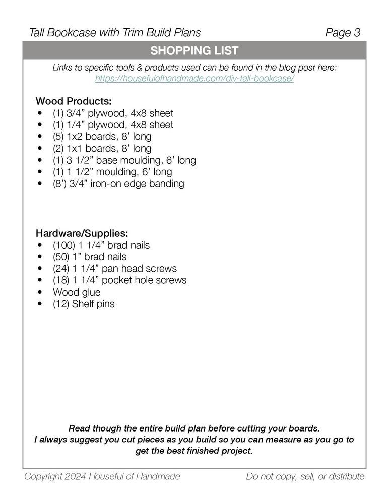

I am a beginner in woodworking and wanted to start building from a smaller DIY project. I have a plan for a bookshelf which I will be using as a shoe rack. In the plan the timber sizes are as follows:
1x2 8'
1x1 8'
Now, I understand the 8' = 2.4m but how about the 1x2 and 1x1?

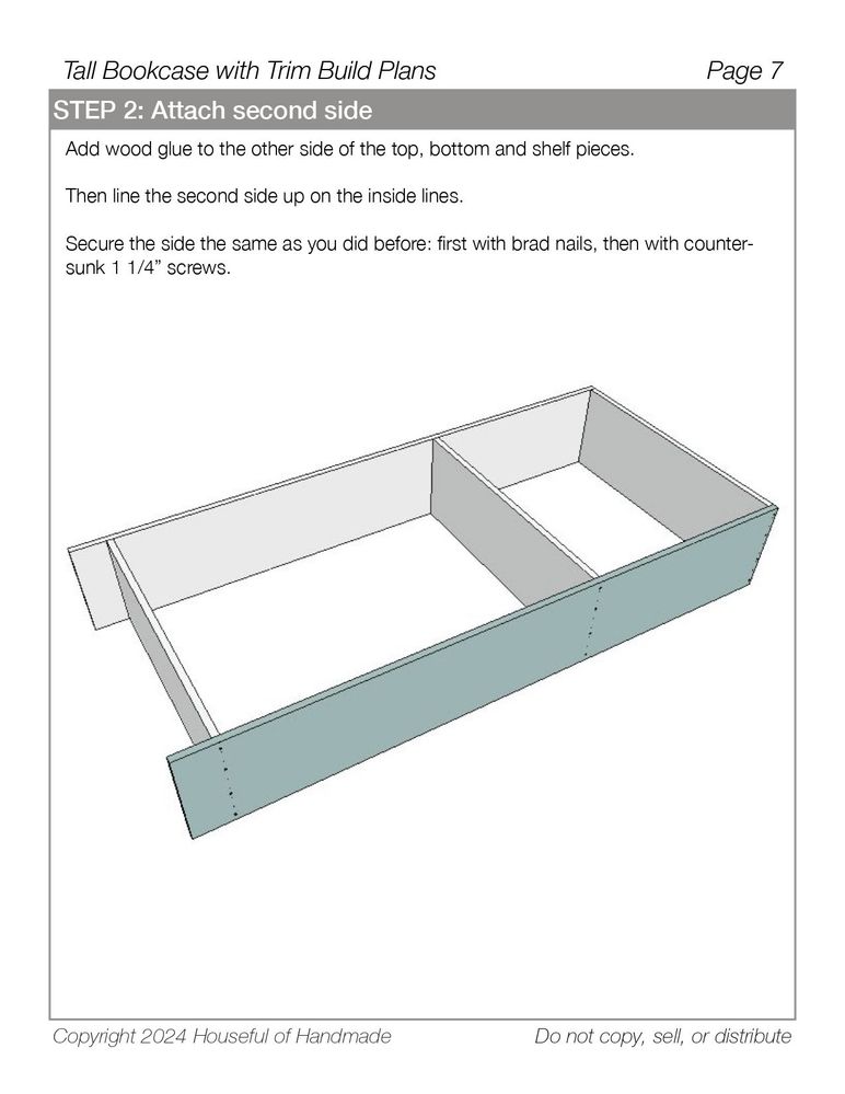

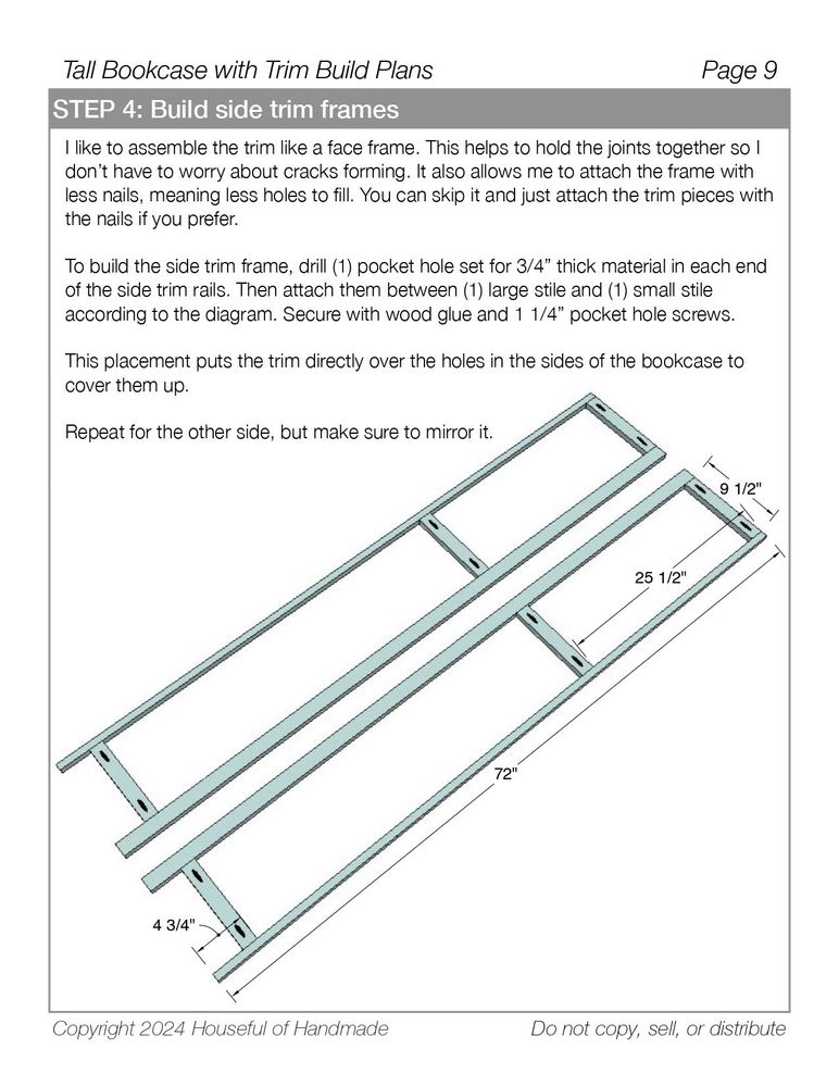

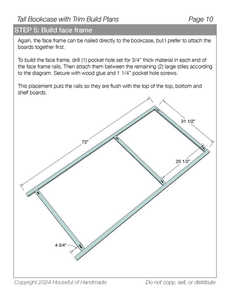

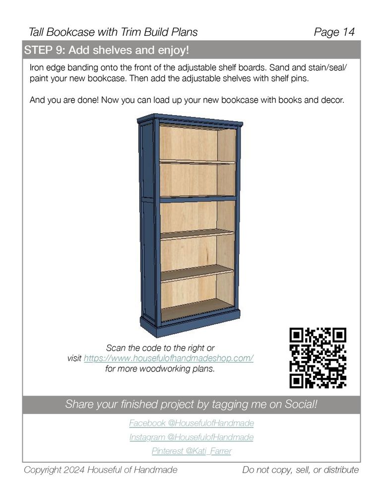

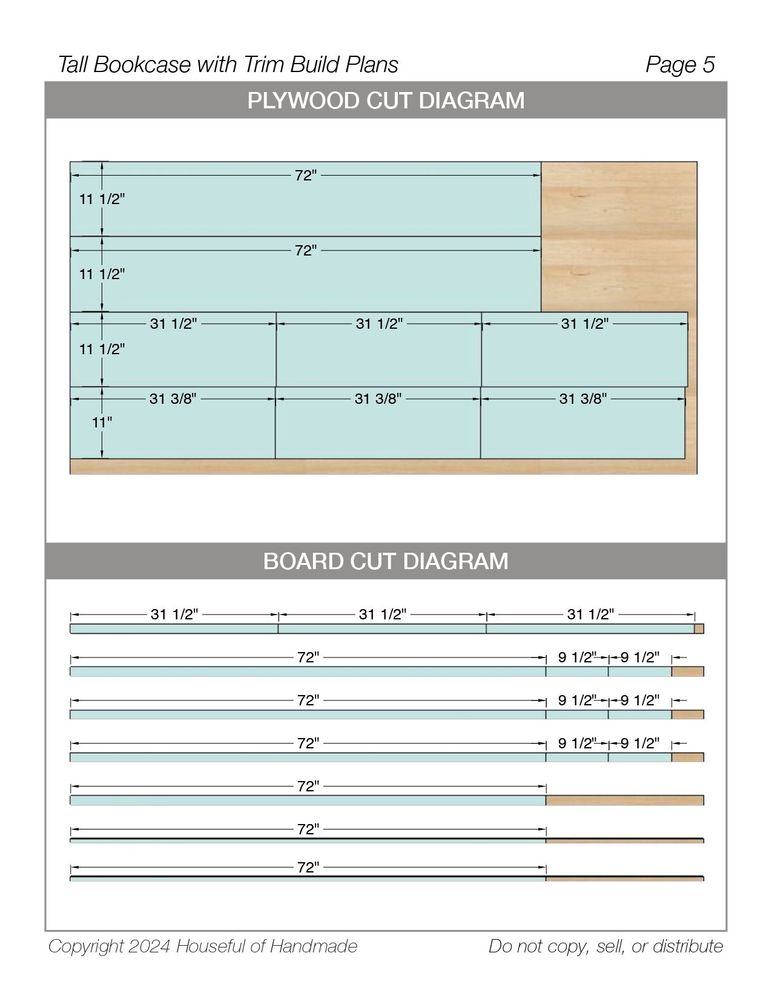

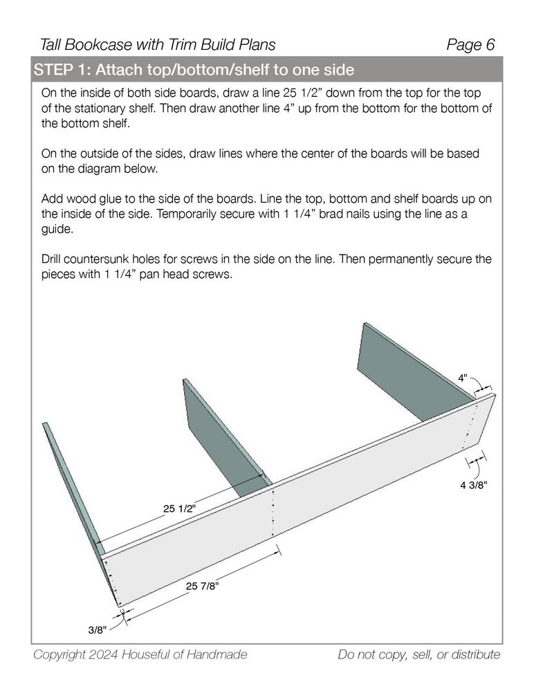

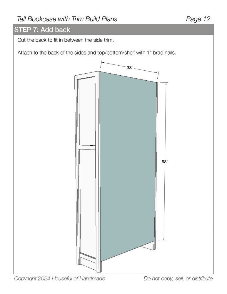

Attached here is a bookshelf plan, which I want to use as a shoe rack adding more shelfs.

Hi Mitchell,
Please see the attached plan what I want to make. Could you please send me the cut list?
The plywood will be 18mm thick.
