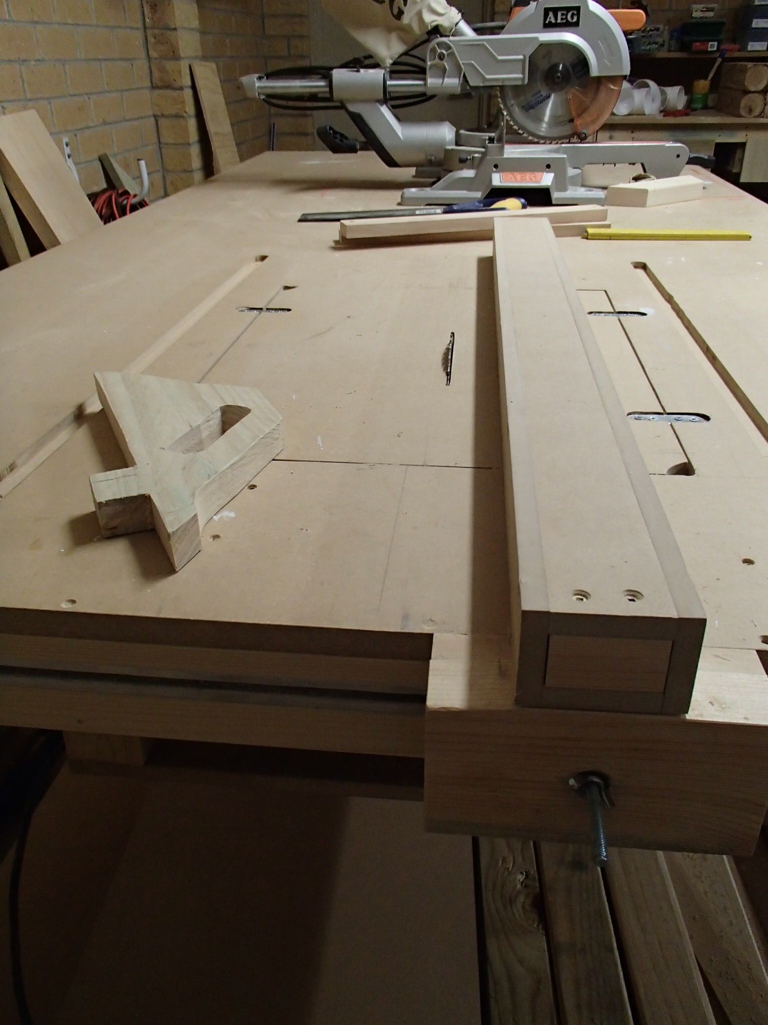

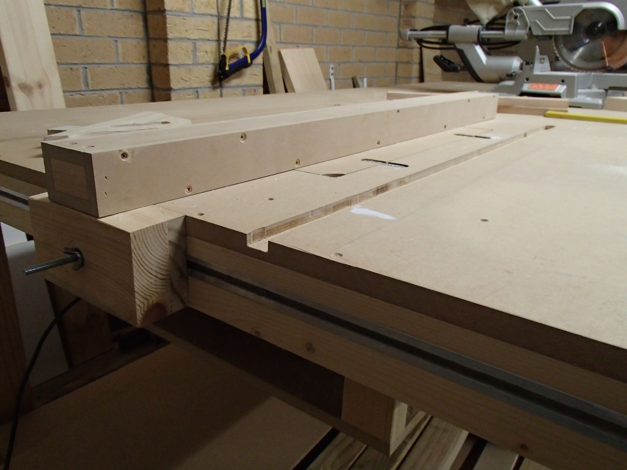

I too have the Ozito saw, It pretty much does all I need and I do agree with you about the ripping fence. Would it be possible to post a photo of what you did?

Hi @Woodsy Sorry for the lat reply in regards to pictures of the guide rail. Busy time with Xmas. Below are a couple of pictures. Everything was custum made for the job. I bought a 10x20 hollow alloy bar and ripped a track in the centre of one side to make a T-track for the guide rail to move on.
