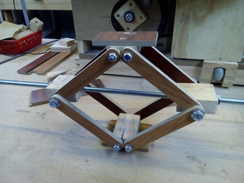

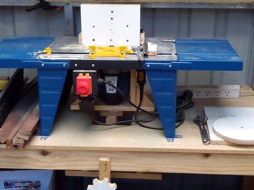

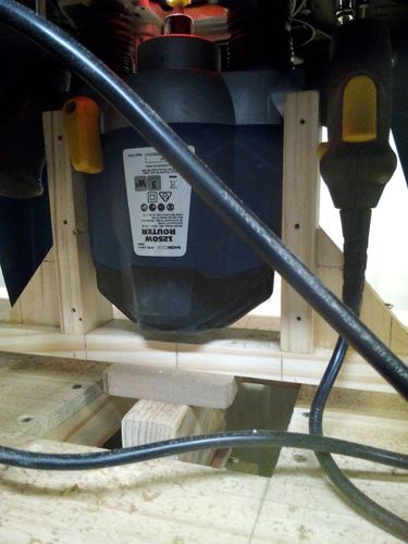

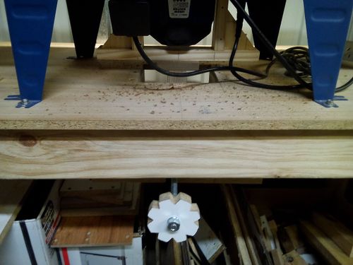

We know the difficulty of trying to set the router bit height with one hand while the other is trying to push up on the bottom of the router and struggling to negate the forces of the plunge router springs. Here are random construction photos of my scissor jack router lift project. All the timber and hardware was from Bunnings (including laminate flooring).
TIP: The only (non grain) timber material strong enough to withstand the screw jack forces was laminate flooring.

Thank you very much for sharing your knowledge and experience in regards to routers. Your scissor jack router lift is an amazing bit of D.I.Y. I'm quite sure it comes in handy and saves you a lot of frustration in regards to router depth.
Again, thank you for sharing such a fantastic project.

Thats a very impressive and clever little invention of yours. Thanks so much for sharing.

I have an old GMC router 'permanently' mounted under the table. To assist with height adjustments  - I removed the two leg springs. Not that I'm a dedicated wood worker - but it works well.
