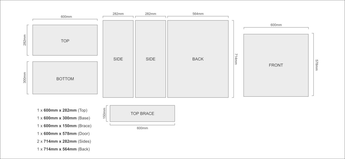

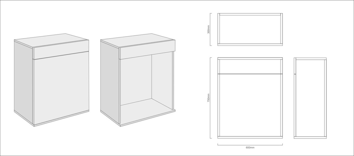

Hello @ZenZhou
I'm a big user of MDF, but there is one thing I always do and that is to add actual timber supports in the corners. Unfortunately, MDF tends to tear itself apart under heavy stress. I don't think it will be strong enough to hold the weight of your fish tank.
However, I suggest using 70 x 35mm Framing MGP10 Untreated Pine 2.4m at the top to hold the weight of the tank. This will also allow you to drill the panels together without worrying about splitting it in the middle. As you will be drilling into the timber frame.
As for the bottom and back panel, I suggest using 42 x 19mm 1.8m DAR Pine Premium - 1.8m. This will strengthen the bottom and back panel and prevent the MDF from coming apart.
I've drawn up a sample sketch to give you an idea of how to install the frame.
