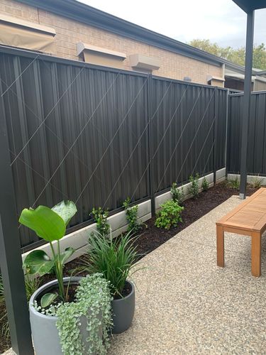

Easy little project at my brother-in-law's place a couple of weeks ago. Took about 5 hours and cost less than $100. Really makes a difference.
The fence is all you can see from one of the bedroom windows, so it needed something to make it less bland. However the fence is very close to the house so we wanted to do something that wouldn't take up too much space.
I made a quick video with a time lapse camera just for fun :smile:
Thanks for checking this out, happy workshopping.
Cheers, Roy

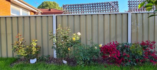

Hi Mitchell thanks for the fast response. The trelis that I was going to use is this
https://www.bunnings.com.au/whites-180-x-100cm-grip-grow-wall-frame-plant-trainer_p3042323?store=731...

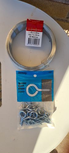

The pictures here are the wires and screws I bought from Bunnings today. Do you think I would be able drill into the white posts on each side of the fence and connect 2 to 3 horizontal rows of wires to support these roses when they're fully grown? I'm hoping the posts would be more sturdy than the thin colorbond sheets.
Thanks heaps.
Re: Climbers to dress up Colorbond fence
Hi @ColinL,
The wire looks like it would be sufficient, though you could have difficulty installing those hooks in the thin metal posts. They're designed to be screwed into timber, not sheet steel, so they might end up a bit wonky. They quite possibly would still work, but people generally screw self-tapping Buildex 12-14 x 20mm Climaseal Hex Head Metal Tek Screws in and wrap the wire around their head before driving them home.

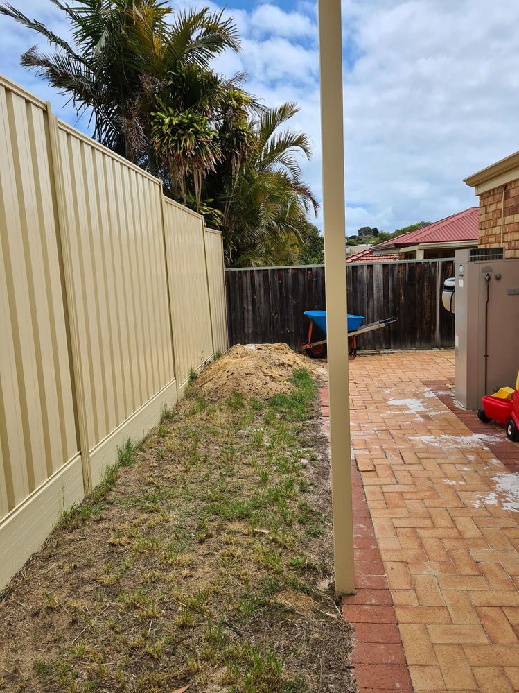

Hi @EricL Thanks for the tips.
A picture of the fence is below.  We are literally starting from sand and weeds and putting in new beds, lawn, etc.
So what your suggesting sounds like we'd screw some lengths of timber DAR batten down the posts and along the top and bottom (presumably with tek screws or something like https://www.bunnings.com.au/zenith-12g-x-35mm-galvanised-hex-head-metal-screws-50-pack_p2409305 to hold the timber into the metal).  Then we'd screw the wire or mesh onto the wood DAR with regular screws.  We might run a length down or across the middle of the fence panel as well so there is an additional point to attach the wire/mesh to.  I might paint the wood as well so that it blends in with the fence.
I'll give more thought to wire vs mesh.  The convenience of mesh is tempting as I don't fancy having to screw in so many wires if we end up spacing them ~100mm apart.
I just notice there is the flower mesh with the 50mm aperture spacing Whites 90cm x 30m x 50mm x 50mm Flower Mesh or the trellis mesh with 100mm aperture spacing https://www.bunnings.com.au/whites-120cm-x-5m-x-100mm-x-100mm-trellis-mesh_p3060027.
I'll post once it's done and let you know what we decide to go for.

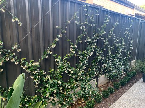

I did the same as Roy
First photo Feb 2021
Second photo Nov 2021
Welcome to the Bunnings Workshop community @bq. It's terrific to have you join us, and many thanks for contributing to the discussion.
That looks absolutely wonderful and is a fantastic reference for our members as to what they can look forward to after ten months. Did you fertilise or encourage the growth in any way? Did you need to assist the tendrils in finding the wire? My Star jasmine tends to find its own way, but I've noticed progress is exponentially increased if I help the new growth find the guide wires and send it in the right direction.
