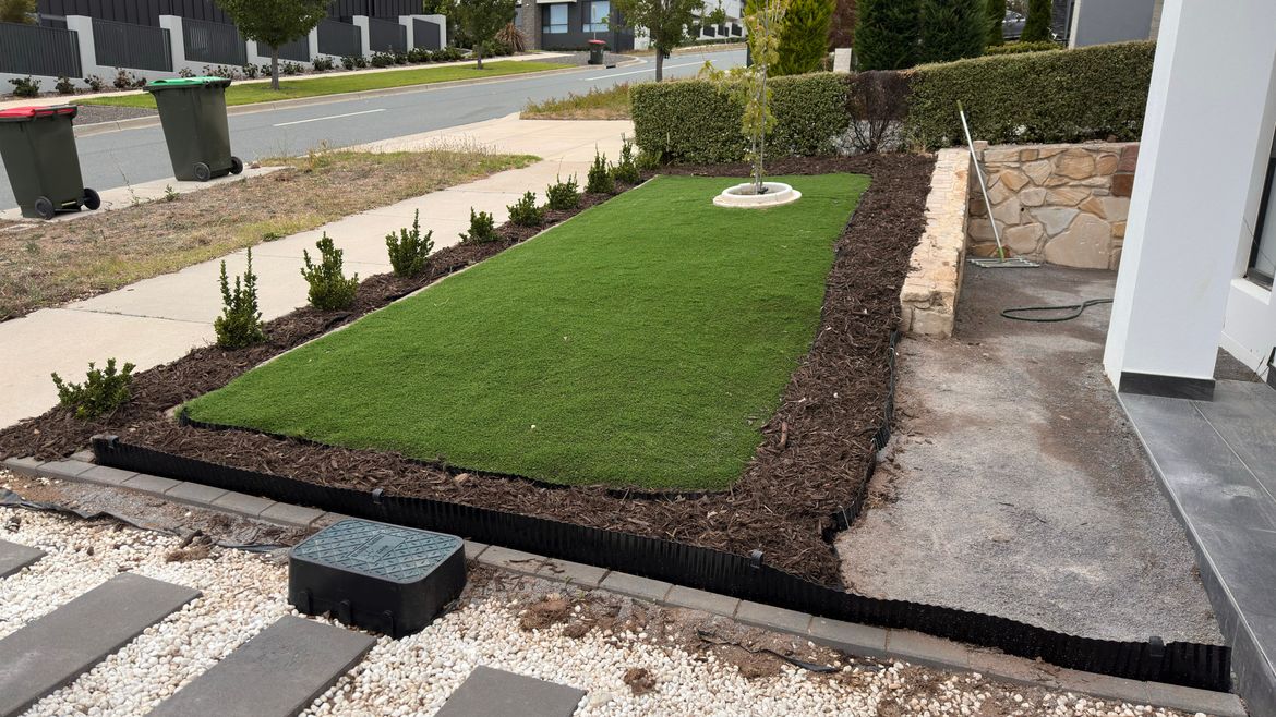

Hi @EricL
Just following up on your above reply to install artificial turf.
I did install artificial turf yesterday. It was a DIY process. So, far it looks good but it looks like a carpet not grass.
I think after using the sand, it will become better.
May I know how to decide number of bags required? Area is roughly 6 x 3 m on a slope
Also, you mentioned using the 14T Garden rake. Once the sand is in, is there any else needed to be done or that is the final step?
Also, if you can provide suggestions for the side entry. So far, just put the remaining blue dust there and compacted the same. Planning to install pavers with remaining artificial grass or maybe be will just put decorative stones around pavers.
