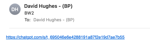

I have managed to find the lamp branding symbols at the base and on at the top - 'BW'.  (Refer attached pic).  Are you able to track/ID  this?

Hi Dave - Our research indicates 'BW' is a British Foundry mark for cast iron works - 'Barrow&Wilson/Barrow&Walker'. Period 1885-1925. Most likely
original ly a gas lamp.
Refer below link
Regards David4321
