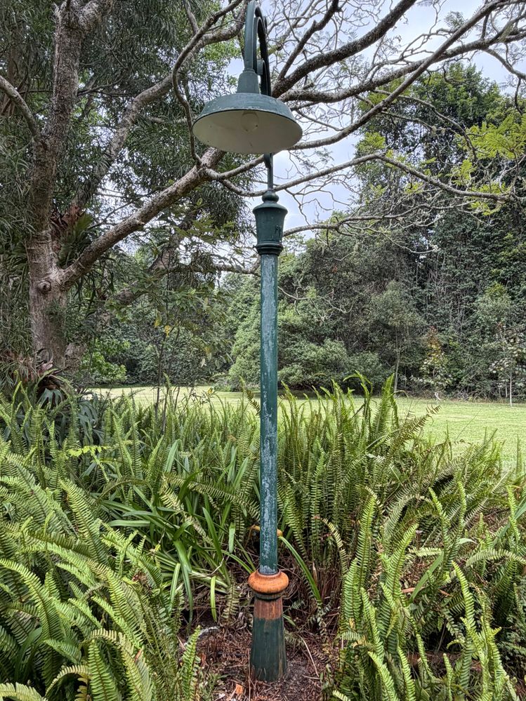

My son Chris checked out the base today and found it had turned into a beautiful RUST colour.! When we saw this originally we thought it might even be a copper base but it is steel.  We will revisit and try and find a manufacturer/date.  Interesting what you found!
Refer Pic.

Unfortunately that is not a gas lamp and likely never was. There is no valve for turning it off and on and the big giveaway is the electric light "globe" seen in the picture (in my experience a gas mantle does not look like that). The restoration comes down to how far back to the metal you want to take it or that it can take. You can get catalytic rust converters to stop any rust but bear in mind it may also be rusting on the inside.
You will also need an Electrician to make sure it is safe for you to work on as it could be live but with a burnt out "globe". Also to rewire it when you want to put it back into service

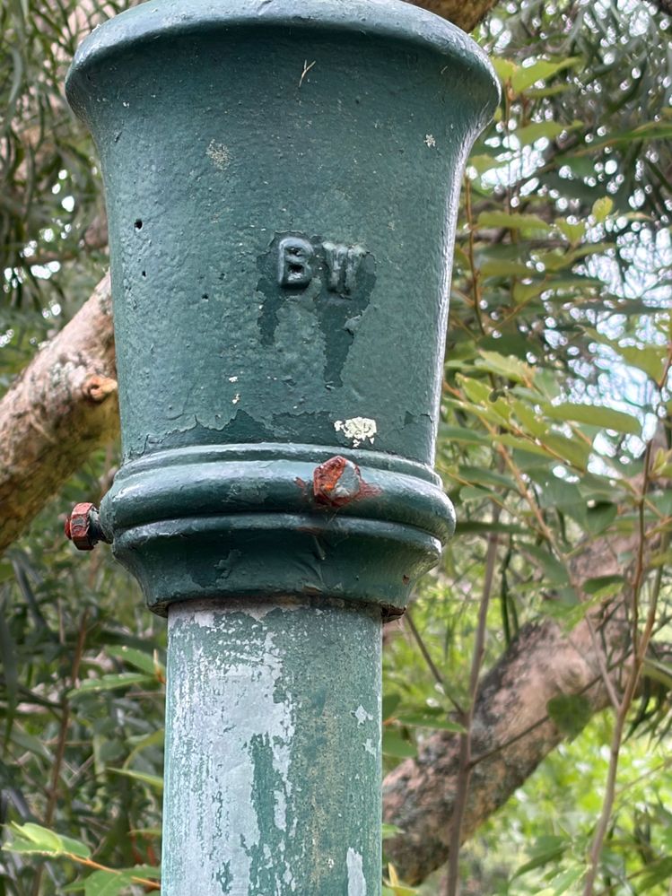

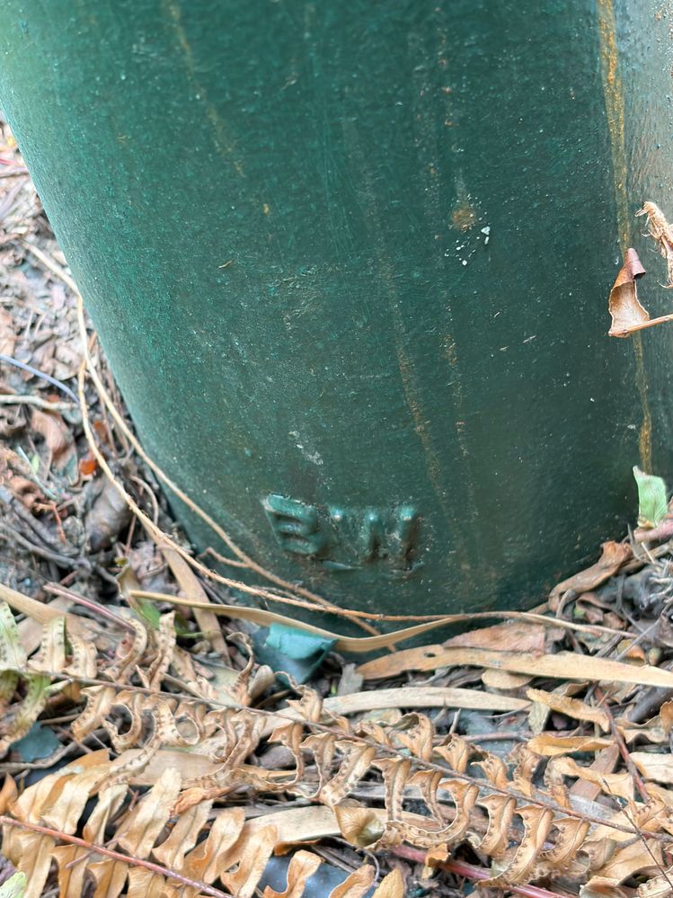

I have managed to find the lamp branding symbols at the base and on at the top - 'BW'.  (Refer attached pic).  Are you able to track/ID  this?
