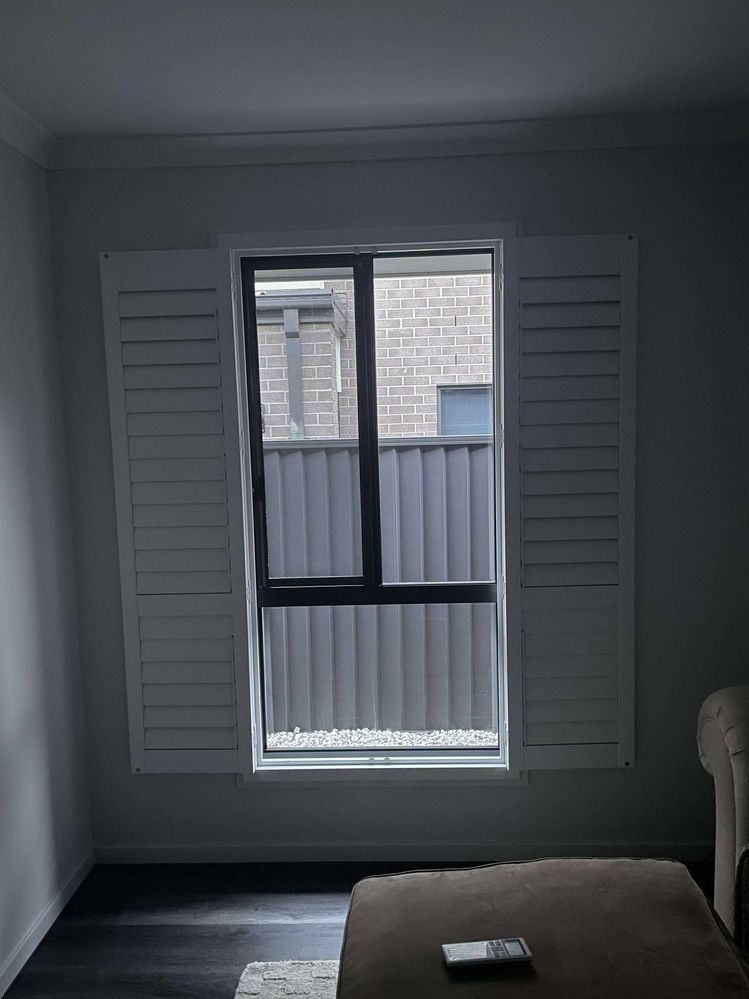

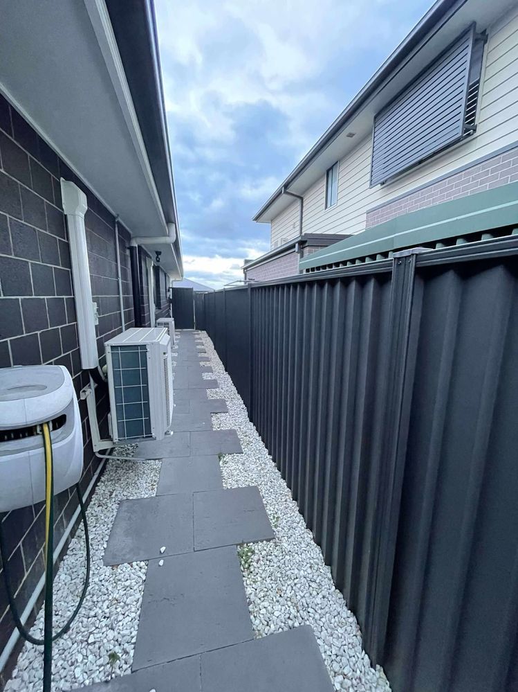

Looking for some advice or recommendations to screen some of this fence line, so that the fence is covered and also ~10cm of screening above the fence line.
The soil is mostly sand and only 9cm deep before it hits some black tarp, so I guess putting in planter boxes / troughs is the only option.
I was thinking something like Lilly Pilly? Or maybe even a type of bamboo? Obviously screening the entire fence would cost a fortune, so only thinking of key areas where the windows look out too.

Hello @NamedUser
Your choice of lilly pilly and bamboo are enough to cover the area you are thinking of. However, it's important that its planting area be sound and fertile. Growing these plants in a planter box is possible, but it would have to be quite big in order for them to reach their full potential. Can you tell us what is under the black tarp? Is there soil underneath the black tarp or is it clay? A lot depends on the quality of the soil and amount of space you have to grow these plants. Other hedges that would grow past your fence line are Sweet Viburnum, Murraya and Photinias.
Another option I would like to suggest is to extend your Colorbond fence just like in these discussions:
Let me call on our experienced members @Dave-1, @Nailbag and @AlanM52 for their recommendations.

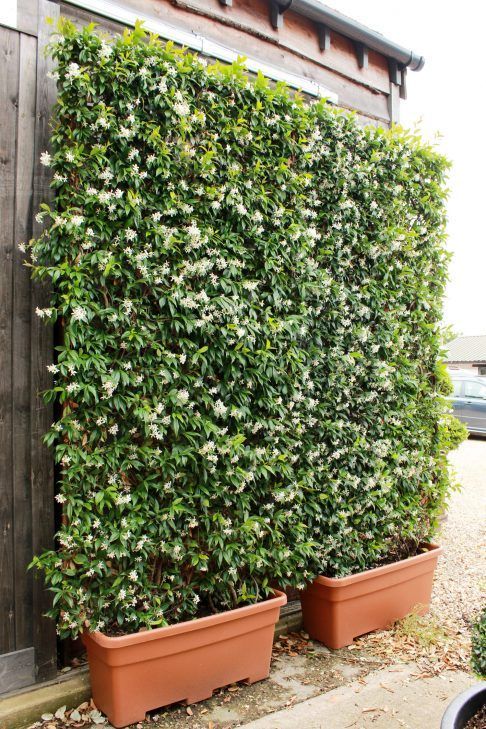

What about doing Star Jasmine in troughs instead? I found this photo online which seems to show them growing 2-3m in pretty small troughs. I could build a wire trellis along the fence. Thoughts? Thanks as always

Picture those planted closer together...
Along your fence line and I am thinking there is not enough for them.

Hi @NamedUser, I am back again.
RE: I could build a wire trellis along the fence.
I did Jasmine and wire trellis along a timber fence, here are some photos.
Even with regular pruning it kept pulling down the fence trellis extensions and damaging the fence palings.
Last photo, as it grows the bottom becomes very tough and woody.
Cheers
Hi @NamedUser,
I'd suggest reading through Training climbers to screen a fence by @royq. You could use this method for planting in the ground or in trench pots, as your image shows. You might also like to check out our Top ten most popular fence projects for inspiration.

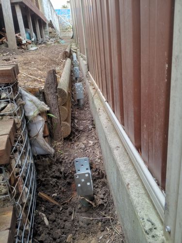

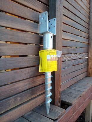

I have been using the Otter 690 x 90mm Ground Screw Stirrup Every 1100mm ish right next to my fenceline. The fence is already tall so I didnt want to add weight to the actuall fence itself. I intend to install posts on these footings and then install slats at the top to give theextra privacy above the fence itself. In your case you could go the route of wire strung between the posts and some slats at the top as well.

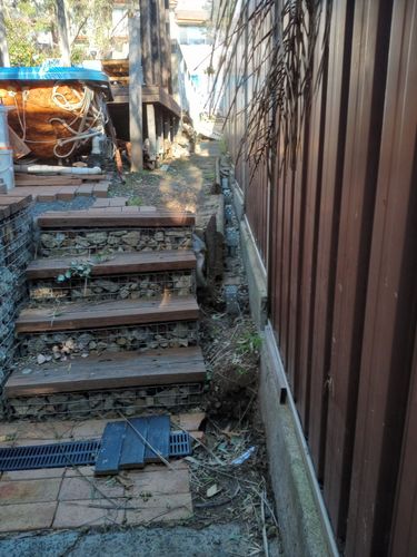

The narrow area I have to work in

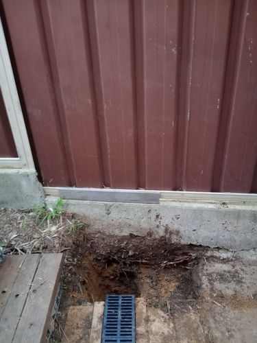

The hole that ened up being an issue as the earth screw "stripped" the thread of the hole when I hit stone at the bottom.
The majority went in very nicely
Actual earth scew

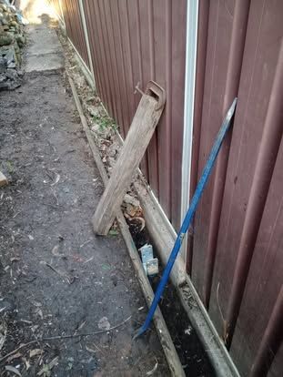

I used a spaer piece of timber to slot into teh stirrupo, A large G clamp and a pry bar to slowly turn the eartch screw into the ground. I would get half a turn and then have to reseat the prybar. I also had a 300mm masonary drill bit that I did a center drill with, mainly to make sure there was nothing solid underneath and also to give the screw a path to follow.
Thinks to note -
Great tool if you have no rocks or concrete.
Yet to find out how well they will support ![]()
If the screw spins, then you will need to go the old fashioned route and dig a hole and add concrete plus stirrup. I had one hole I had to do that for.
It will give something solid for a vine to climb (on the wire) instead of impacting the fence.
