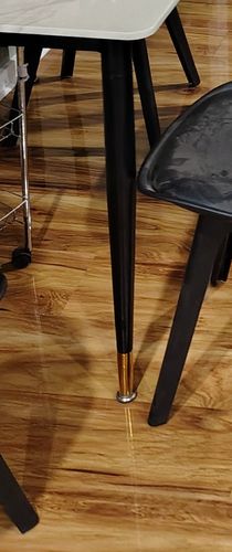

I wanted to convert my lightweight dining table into a portable one to function as a kitchen island/extra bench space. The only issue is the bottom of the leg is round and I don't think I can remove the gold bit.
My workaround was to add a square timber bit and then add casters to the timber. I'll come in store to ensure measurements are correct etc, but just wondering if that would work? The legs screw off so I was going to bring that into store as well. Just thought I'd ask here in the mean time to see if any other ideas came up 😊 thanks in advance.

Trying to figure out a way to attach a caster and maintain some strength at the foot of the leg. I can see the dimple in the gold metal that holds the foot in place at the end of the leg. You could modify that part of the metal leg by chopping it off and using the gold barrel to hold the caster with an expanding screw/rubber but getting all four legs exactly the same height will be problematic....
Screwing a caster directly to the end of the timber with no metal ring reinforcing the timber will lead towards the smaller round leg splitting.

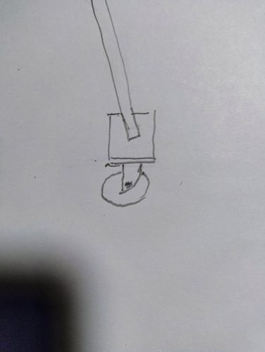

Maybe something like this.
That looks like a kid's drawing 😳

Position the block behind the leg and pencil the angled outline.
Drill/boar a hole to suit the leg, if it ends up oversize use 5 Minute Epoxy.
