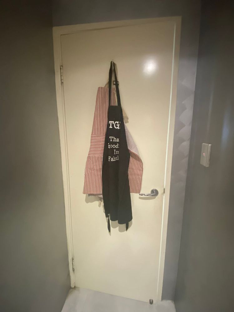

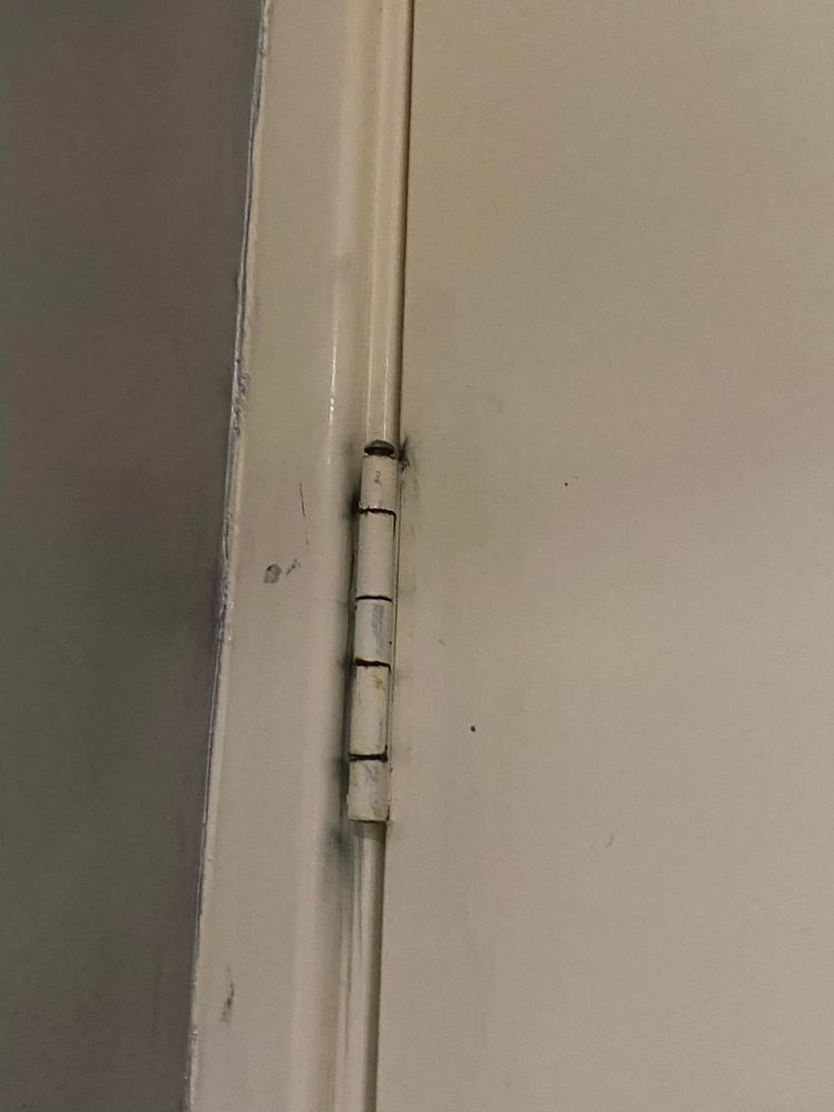

Thank you so much for your replies and yes it makes sense what you all have said.  I didn't think about the weight of the Timber Panel I was thinking of with the hinges.  We have a metal door frame and some crappy looking hinges.  I have attached photos of the door and frame and a close up of one of the hinges as requested.

I haven't seen someone use one of these panels as a door before, but as mentioned, it would probably work. Multi-use panels are typically used for benchtops and the like. They are glued together strips of timber and generally not suggested for hanging by their edge. Your hinge screws will penetrate into the depth of a couple of strips of timber. So, the entire weight of the door will be supported by a single glued joint in the timber. Whether this glued joint is capable of supporting the weight and stress of being used as a door is a bit unknown.

Using your existing door you could sand the surface so its roughed up and then use Porta 35 x 4mm 1.2m Tasmanian Oak Square Edged Board  or something else as thin (Bunnings have more I am sure but wander through the timber trim isle and you will see a large range)
I would remove the door from the hinges, taking note of how it opens so you dont make it thick when it will jamb or catch, lay it on some timber horses. Then sand. Once you are happy with the roughness (its to give something for the liquid nails to grab onto) then start with an edge and install strips of the timber trim. I would make sure that the lengths are cut square as once you have glued them down they wont be moving :smile:
It will add extra weight to your existing door, but hopefuly not as much as that solid timber you were originally thinking of. You only need to do one side, the other side I would sand and paint to match.
