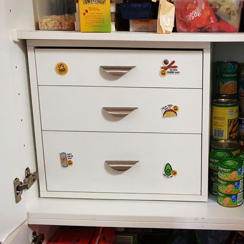

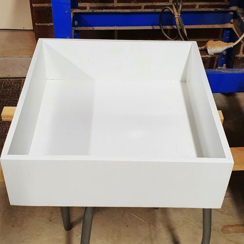

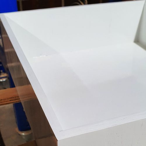

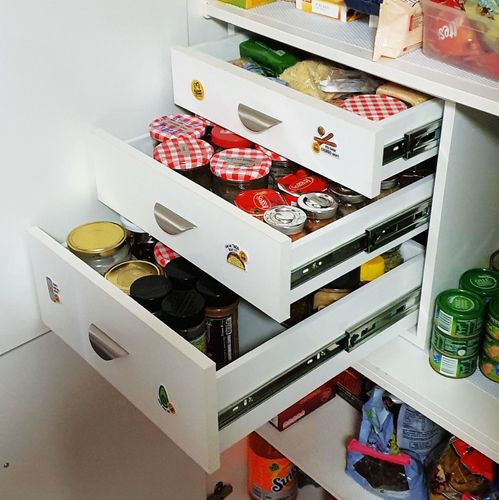

When I got tired of having various size spice jars piling up in the kitchen cabinet, I decide to make this drawer unit which sits inside of the cabinet. The body is white melamine board, edge banded with white pvc edge band. Drawers made of 12mm structured ply and painted with Rustoleum x2 white spray paint (2 coats).
Soft close slides, handles, some stickers courtesy of my sons and apologies for the mess

What an elegant solution to a very common problem. Especially if you've got jars in a variety of sizes. Makes things much tidier. Thanks for sharing @EdwardW. Do you have plans for any other projects around the house?

Fantastic project @EdwardW. The quality of finish easily rivals pre-made units. However, you'll seldom find one that takes into consideration small containers. I agree that because of their non-stackable nature, small containers take up far too much room in standard cabinetry.

Beautiful work. You can actually do this with the whole pantry. Use 155 degree zero protrusion hinges on the doors, that will give you clearance from the inner drawers. Use the whole carcass width. Look at Blum inner drawers. Can get deeper if needed , but you have done awesome.
