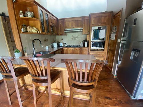

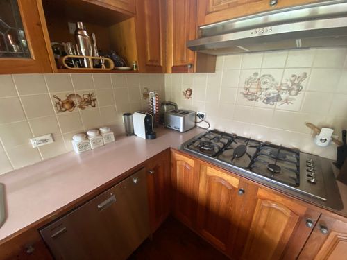

Hi Workshop Community. Hoping you can help me out. We are getting our house ready to rent out but want to freshen up this small tired kitchen. As the cabinetry is still in good condition I will just clean and re oil but the splash back and bench top needs to go. I have timber floors and exposed timber beam ceiling so with a lot of timber it darkens the area. The kitchen is in the lower part of a split level home so the area is open with a wall seen behind in the top level. To brighten it up would you recommend a white glass splash back and a whitish stone bench top or similar. Open to any suggestions on how I can brighten/refresh keeping in mind it will be a rental. Looking at only putting approx $1.5-2k into it. So appreciate any advise :-). Cheers Shel
Sorry should’ve mentioned. Looking at using Kaboodle products and or Dulux renovator range. 🙌

May I suggest instead of oiling the doors to paint them in an off white like "Lexicon" this will straight away brighten the room. Keep your tiles and paint them with renovator range in a very light "teal" perhaps 1/4 strength. Make sure to paint that door on the right white, but only that door to hide it when looking in the kitchen. You can use the benchtop paint to change the color of your benchtop to something brighter. Last tip to put LED running lights under the wall cabinets to add more light and dispell the darkness.

It looks a great project to work on as everything is in good condition. The floor looks really stylish and the cupboards look strong. (And I love the look of the barn door that I can just about see on the left in the first picture!)
I think @redracer01 has a really good point about painting the doors a light colour rather than oiling them. As the cupboards look in such good condition they would come up really nicely with a lightly coloured shade, and it would lighten the whole room. Adding some LED lighting under the cupboards would definitely also help with that and give a new look to everything. If you did those two things it might be worth considering a timber-style kitchen top to pull together the floor and the beams. Kaboodle do some really nice timber benchtops that would really shine under some LED lighting when varnished.

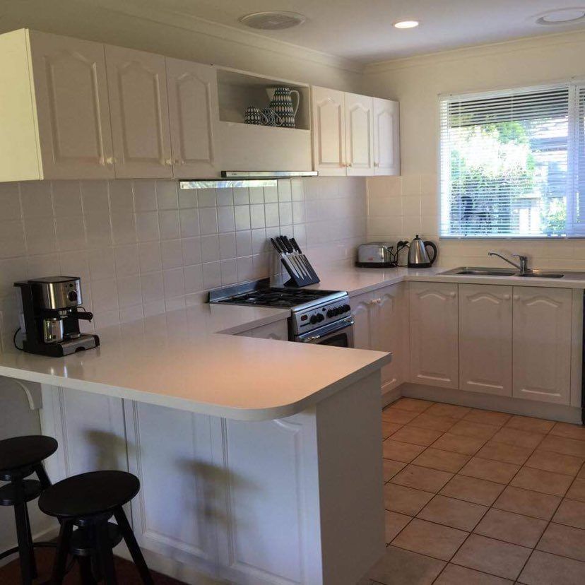

However, if you wanted to save the most money and get it finished fast so you can get tenants in, don't be fearful of painting everything white, including your benchtops.
The tradeoff is that the finished product won't be as serviceable for the long haul, however, by then you might be in a position to do a whole new kitchen, redesign, open up the wall space etc.

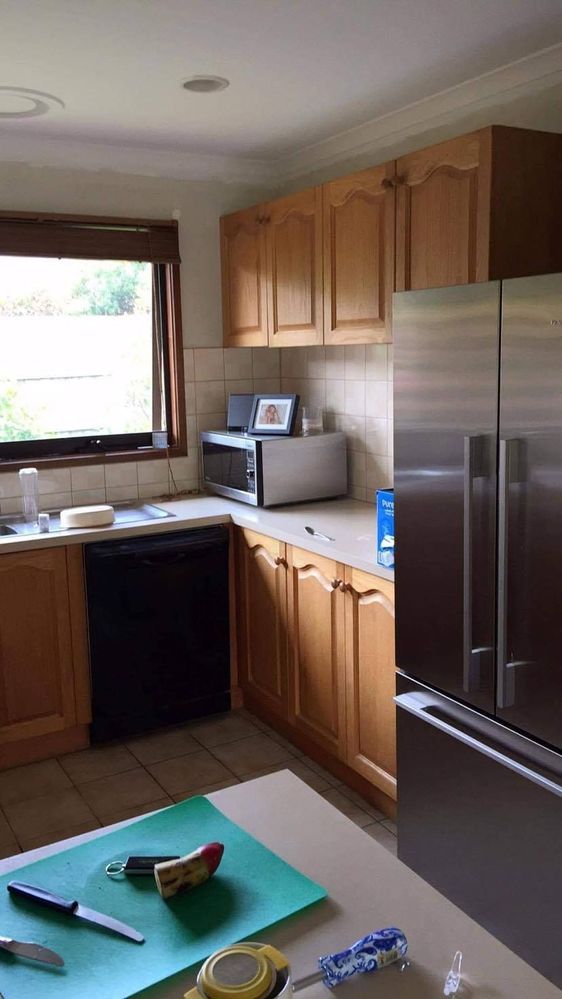

Here are the before and after pics from client Jan so you can get a visual. The purpose was to get the house on the market (Airbnb rental Mount Martha Vic) asap and upgrade the home on a small budget. She painted everything, including the wooden door knobs. That was about 3 years ago and it's still going strong.
You could remove the upper cupboard doors that contain the glass, bog the holes and paint the shelves too, leaving them open.
Sorry Jan's pictures aren't taken from the same angle.
Good luck and I love your barn doorBefore
After

Oh wow @2Belindas what a transformation. So bright! Love it. Thanks so much. Great to see a similar style kitchen to get a good visual on what we can achieve. Thanks re the barn door. Amazing what you can do with old pallets.
