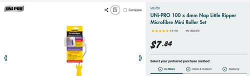

Hi @Garfield28
Just to add to @EricL suggestion, I have used a small roller with 4mm nap size. These rollers give a good finish.
https://www.bunnings.com.au/uni-pro-100-x-4mm-nap-little-ripper-microfibre-mini-roller-set_p0022470
