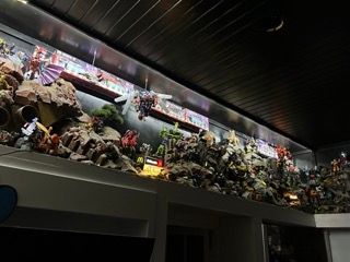

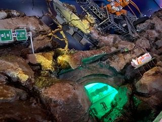

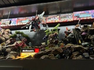

I have another very large display i have built for my robot collection so Ive have had way to much experience making small landscapes! Unsure if the group here would like to see as it ventures into modeling i guess more then DIY.
