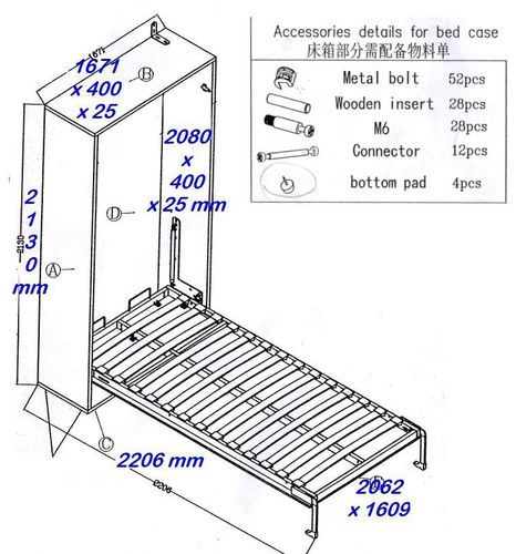

My wife has bought a full Murphy bed kit, all except for the timber bits. Attached is the overall look of the bed from their Instruction booklet.
That leaves me with 2 Questions.
1. As the Specrite panel is a laminated board, will it have sufficient strength to handle the mounts for the frame?
Hint: the usual occupants and dog will add up to about 250 - 300 kg.
My thoughts were to use the SpecRite 2200 x 600 x 26mm Multi-Use Merbau Panel as the best option to hold tight the mounting screws. The backplane and under-bed panels will probably be BC (as the facing panels need to be furniture grade) or CD 17mm ply.
2. The bed frame manufacturers suggest keeping it all together with the fittings shown in the top right of the image. In other words, the kind of light to medium-weight cupboard fixings that you could expect to find in any kitchen, or cupboard flatpack. I have successfully used these many times in the past on kitchen cupboards, shelving, and other furniture but I think the Connector Cam sets are not adequate for fixing these heavy sides to the back plate and transferring all of that strain and stress.
I have bought some packs of the Connector Cam bolts but I am open to suggestions on better ways to fix the backplane to the surrounds and butt join the two pieces of 17mm ply needed to make up the backplane and the pieces under the mattress. They suggested double-ended Cam Connectors but couldn't find any at my Parafield SA store so I also bought some of the Hafele Benchtop connectors only to find they stand too high (22mm high) and will have to go back.
What is left for me to try? 2024-0315-1248 murphy bed plan D.jpgPocket screws maybe?

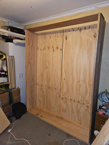

Since getting them home I have identified each piece, measured and marked them, and brought the actual parts into the spare bedroom to mock up how it might look.
I think this is going to work and I am very excited.
Oh, after a lot of running around town, because Bunnings won't cut down any outsider timber for obvious safety reasons, I got the 45 mm thickness cut back to 25mm. With plans for the 10mm offcuts, I am delighted with the job by Moyle Bendale Mouldings, just across Cheltenham Parade from the Bunnings Woodville store.

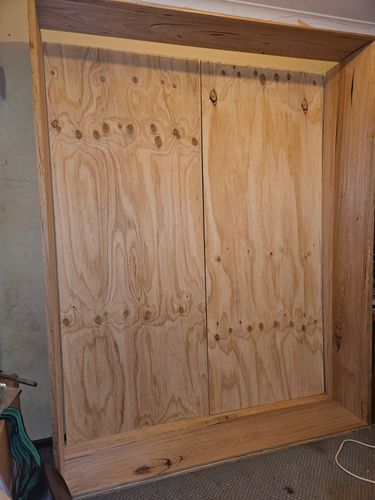

So, tonight I mocked up how it might look. It is great to see it come together after these months of planning, pricing and drawing.
 The pieces are just sitting together, just to get the feel of how it might look when done.

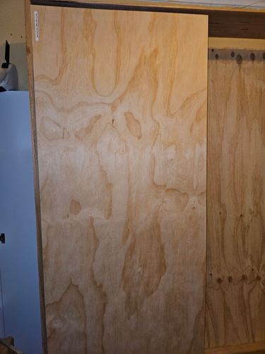

 The gaps in the back panels have me worried. It has all been cut according to the plans but the gaps do seem to be there.
 Note that here we see the B side of the 3mm BC plywood that will be the facing skin when the bed is folded up. In later pictures, you will see that we have chosen to use the C side as a better fit for the tone of the bedroom.
 This picture shows the C sides of the 3mm ply. My wife and I, and the future bed users, all agree that this will be the better side to use.

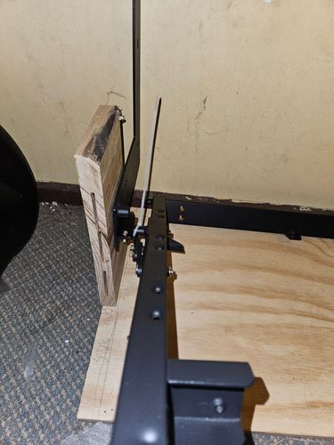

These next photos show the frame and mounts jerry-rigged to check the final width of the bed portion - 1625mm. With the 25mm of each side that makes 1675mm width. The plans say 1671 but their mechanism tells a slightly different story. I think that we will make it, just.

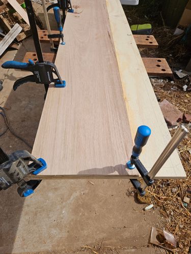

Here I am using the 10mm offcuts of Victorian Ash to fix onto 15mm Ecoply. I have had to use a double row of 20mm screws abd lots of clamps because the offcut has a slight curve where the bandsaw cut the 45mm down to 25 and 10 mm.
These will be the Top and Bottom of the box. So far the Bottom is completed and in place, drilled and just waiting for the sides to be screwed on. Top is the next job.

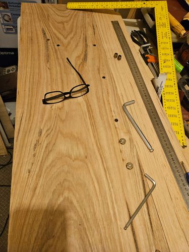

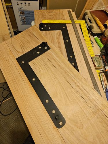

I have sanded down the big sides (2080 × 400 × 25mm) using the Ozito detail sander. So much recharging to get both sheets down to at least ax240 grit finish.
I have drilled for the M8 Insert screws/T-nuts and fitted the side plates that will hold the bed frame axis point.
