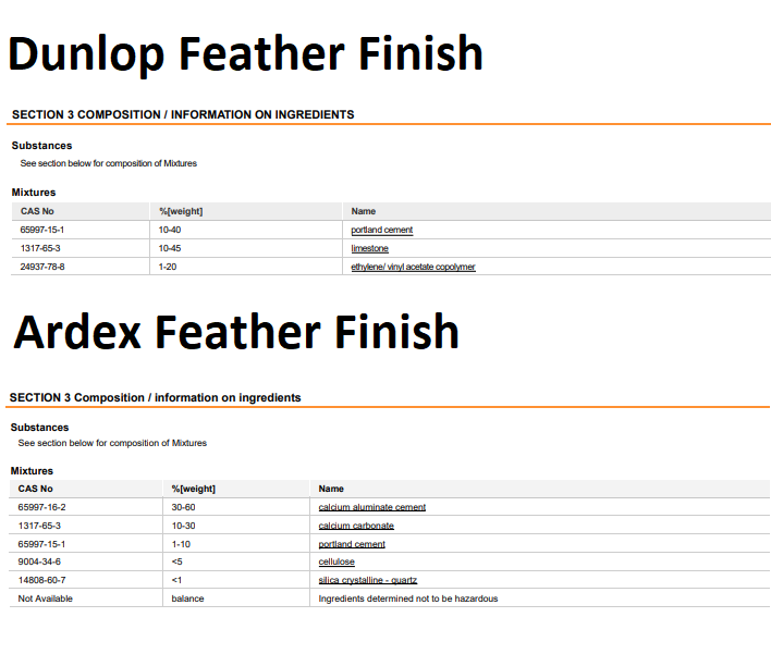

@Andadams used the Ardex Feather Finish, would the Dunlop Ardit Feather Finish work just as well?
Re: Concrete Table Reno
Hi @PDM,
Although both these products are manufactured by Ardex, carry a very similar name and have almost the exact same characteristics, they are not made from the same ingredients. Given this, I don't believe @Andadams will be able to answer your question unless they tried this product too. It looks like @Andadams went through some trial and error, so it might be a similar case if you wanted to try the Dunlop Ardit Feather Finish. My concern with the Dunlop Ardit Feather Finish is that it is predominantly Portland cement. In contrast, the Ardex version has several other elements that might have directly contributed to the success of this project.

Hey Mitchell,
thanks for the reply, I will just fork out for the Ardex Feather Finish
