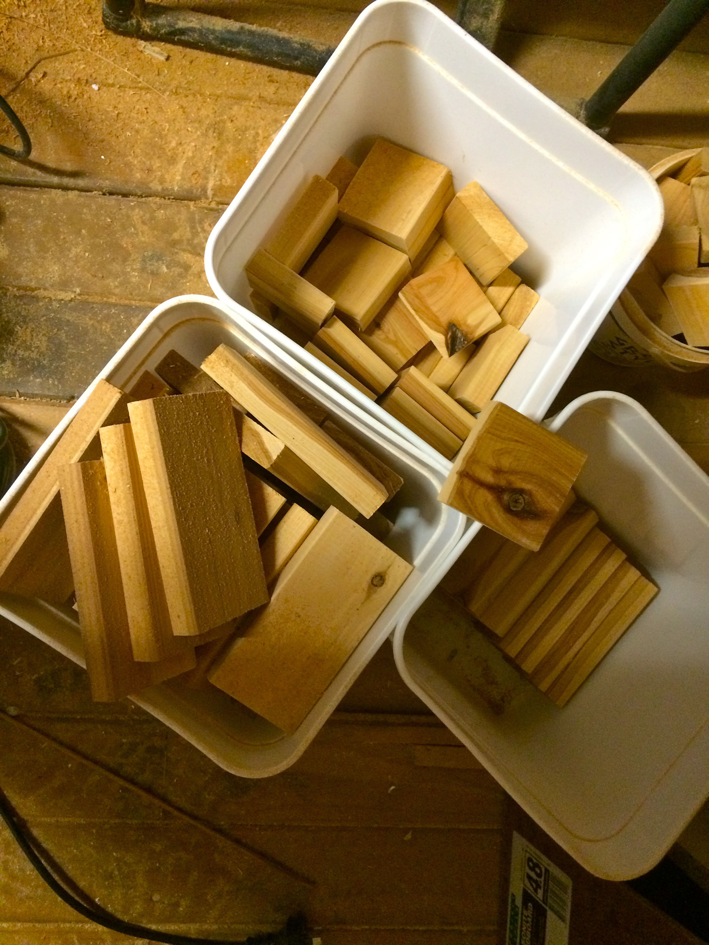

the first thing i did was to cut the pthen ickets into small blocks using the compound saw, with a stop block so all blocks were the same size, as you can see ,i used 2 different size blocks,with the second being twice the length of the first, so once again i set a stop block and cut the rest of the blocks.

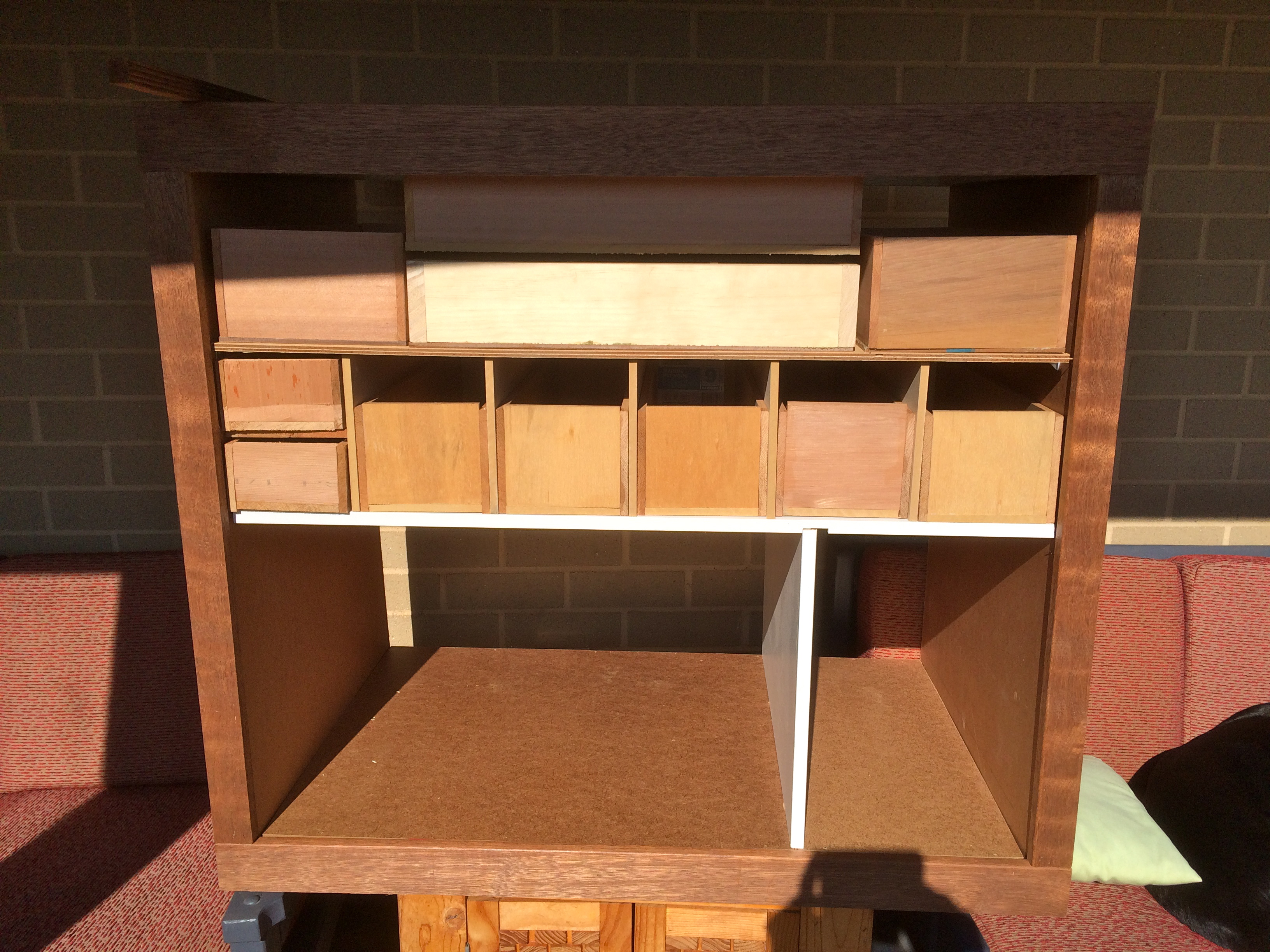

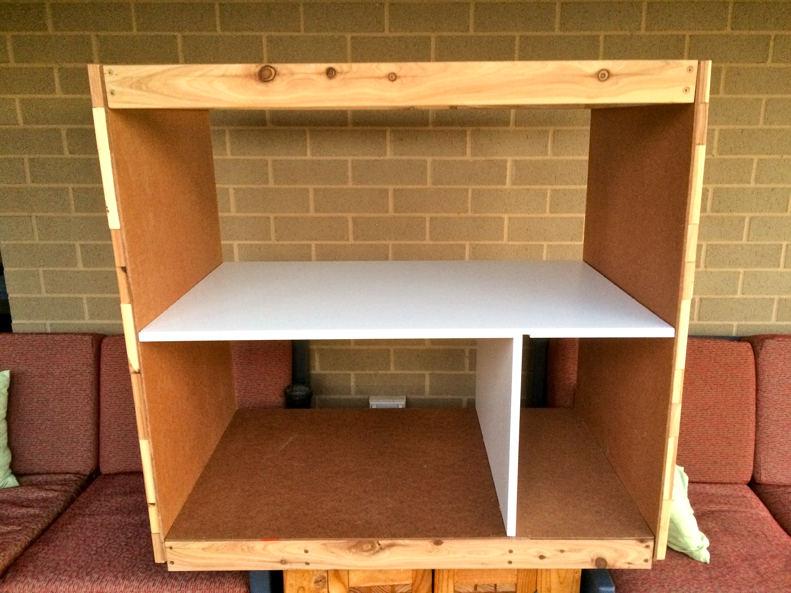

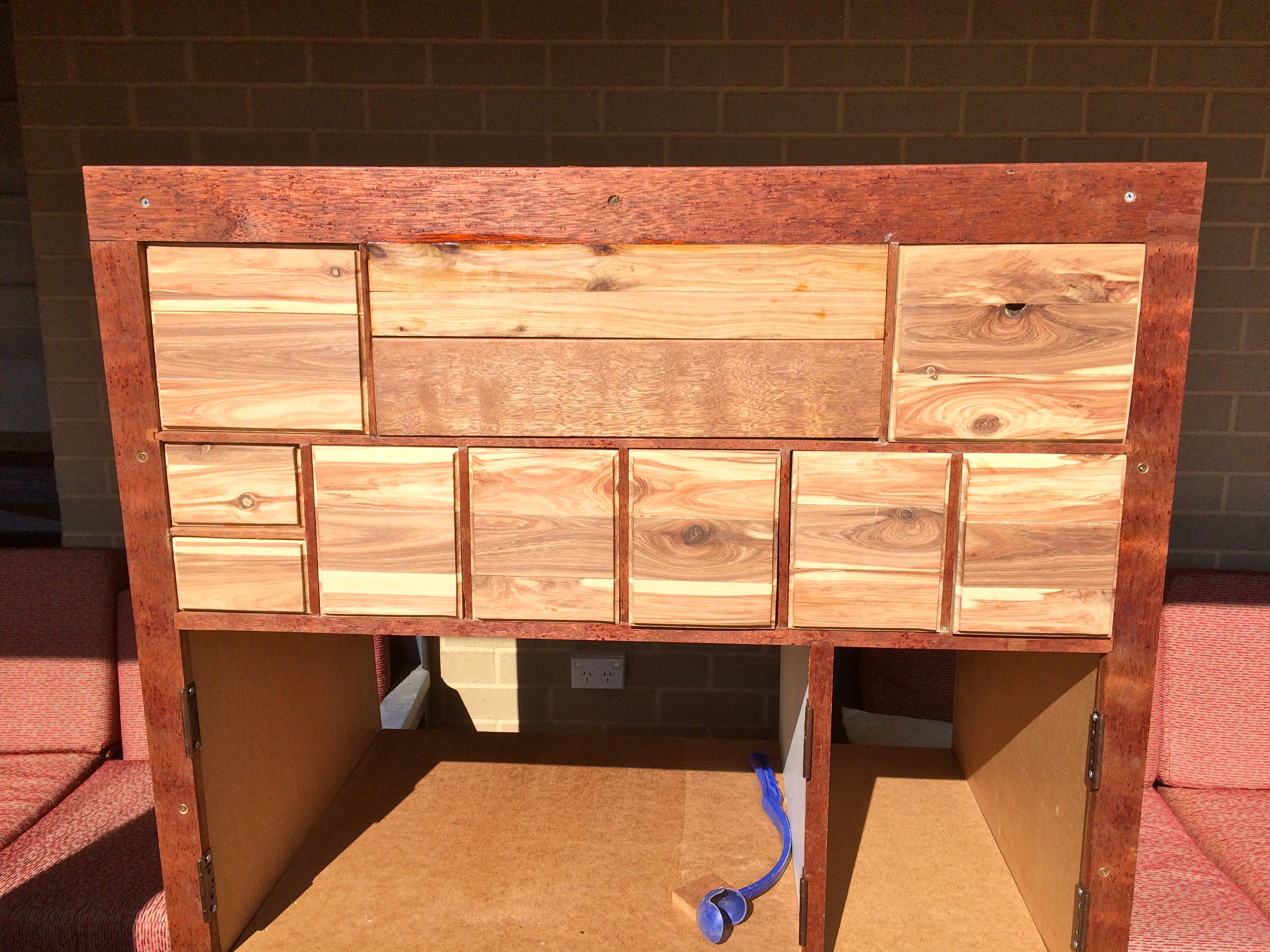

then i made a simple top and bottom frame from 2x4 to the dimensions of the space where i wanted to put the cabinet,less 50 mm,to allow for the sides thickness.then i attached the sides and used a piece of masonite as the cabinet floor.this now gave me the inside dimensions that i had available to use,so i measured all the equipment that i wanted to put in the cabinet and then set about constructing each area accordingly,making the most of the available space,as you will see from the photos.the draws were all made using some tongue and groove cladding that i had,i just ripped the sides of them and made the drawers all of which have a force front on them made from the cypress pickets. the handles were all made from the decking boards and rounded over using the sander.the doors are also made from the pickets with a rebate for the perspex.usually when you make a cabinet ,you make the face frame first,i made mine all most last, and it was made out of merbeau decking board,which i ripped to the sizes i needed.the top is made from the 3rd sheet that i did at the start and is cut into 3 sections and trimmed down to the required sizes and attached with hinges.then i attached the castor wheels to the bottom,sanded it all and gave it a lick of esterpol.i hope this gives you a bit of an idea how i made the cabinet,
