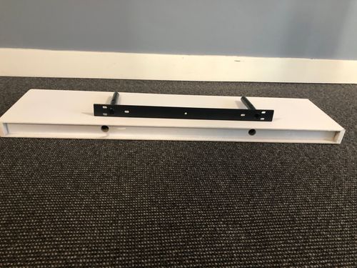

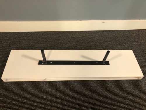

Would it be possible for you to post a photo of the shelves and brackets you are planning to attach to the wall. Once we see what you will be using, it will give us a better idea of what to recommend.

@EricL I have attached photos of shelves I want to hang on wall. Floating shelves with the shelf fitting over the mounted brackets. The shelves themselves are not too heavy - maybe 2-3Kg.
if possible I’d like to hang them in my kitchen and store glasses or mugs on them.

Thank you for posting those photo updates. I recommend using the Ramset 10 x 50mm Ramplug. According to the Hebel Fixtures and Fittings Guide, it is indicated to hold a maximum load of 12kg. However, if you wish to be extra secure I suggest the Ramset 12 x 60mm Anchor RamPlug. I propose bringing the shelf bracket with you when purchasing the plugs and screws to make sure that they will fit. Please make sure that the screw heads are not so big that they prevent you from pushing your shelf all the way to the wall.
