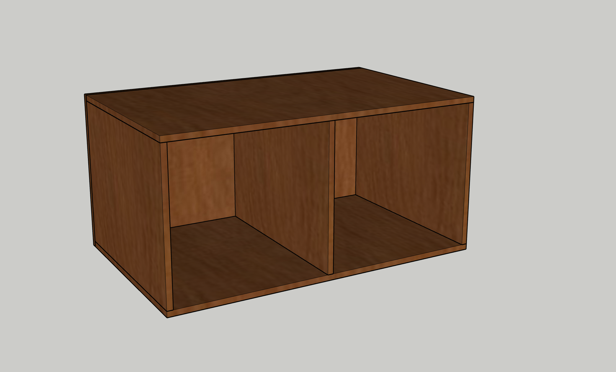

I would start by building two separate sections, starting with the base.
You would need two sheets of equal size for the top and bottom, three of equal size for the outside walls and divider piece and one to form the back.
You can predrill pilot holes using a Countersink Drill Bit then everything could be screwed together using 40mm Countersunk Timber Screws.

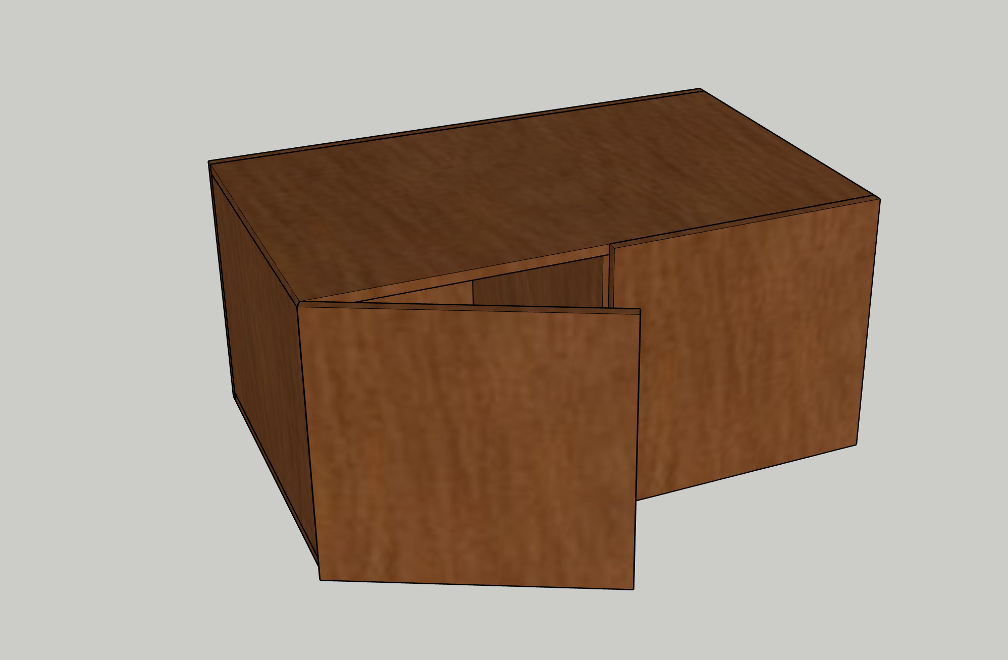

Then, you would add two doors, which will be half the width of the front, minus 2mm to allow for a small gap.
These doors would then be attached with full overlay cabinet hinges.

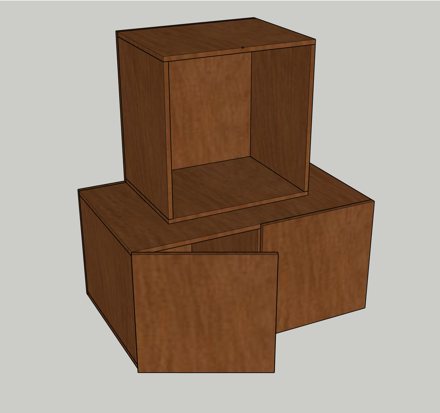

You would then use the same principles to create a second piece to go on top.
You'd need two pieces of equal size for the sides, two pieces of equal size for the top and bottom, and then a piece for the back. You can use the same screws to screw it together, then drive 30mm timber screws down through the bottom piece to attach it to the bottom cabinet.

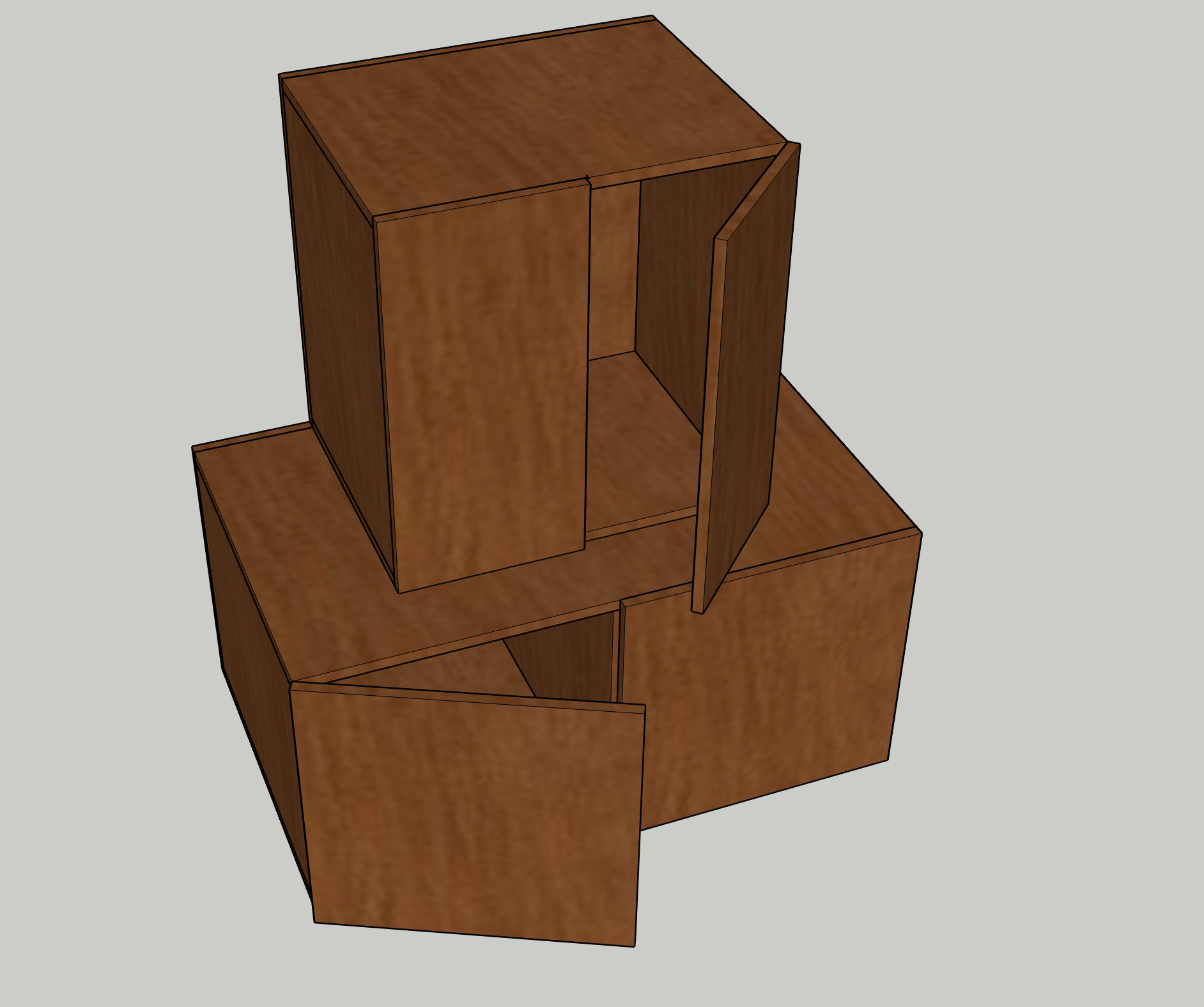

You could then add two doors in the same way as the bottom, by halving the width of the cabinet and deducting 2mm for the gap in the centre. You can then use the same overlay hinges to connect them to the cabinet.
This will give you the basic structure of the cabinet, which you can then decorate and improve using things like timber trims and cabinet hardware.
