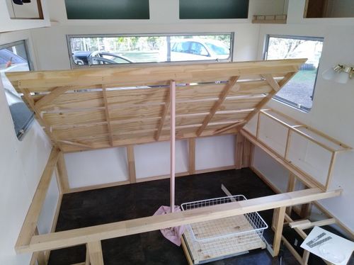

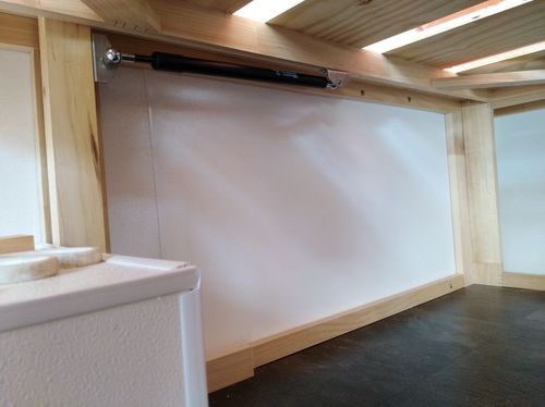

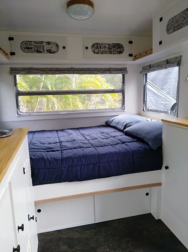

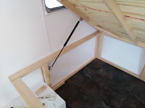

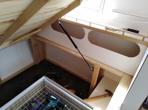

I absolutely agree with keeping the weight down as much as possible.  My Bunnings doesn't stock meranti (smaller store), although I did special order some in to add extra support and noggins to the walls before I lined them. I used various sizes of 5.4m fj pine and 12mm ply, 3 door hinges and 2 gas struts, hopefully the below photos will give you an idea.
 Basic frame built in place and attached to the wall frameBasic frame built in place and attached to the wall frame  Slated top made from 1 sheet of 12mm ply cut into slats and attached to a pine frameSlated top made from 1 sheet of 12mm ply cut into slats and attached to a pine frame  Gas struts added to both sidesGas struts added to both sides  Head board added to use up extra space and provide storageHead board added to use up extra space and provide storage  Gas struts on both sidesGas struts on both sides  Storage accessible with either lifting bed up or using sliding doors underneath, basket drawers slide out on runners for quick access.Storage accessible with either lifting bed up or using sliding doors underneath, basket drawers slide out on runners for quick access.  Finished bedFinished bed
