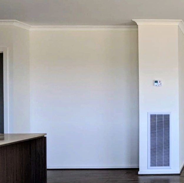

Hi @Nailbag , that's interesting. I was worried about the weight of the desk panel + computer & other items causing the desk to sag without enough support throughout the width. So you reckon that's not the case? And yes, it is on a u-shaped space as shown in the picture.
Re: How to build a floating study desk?
Hi @Jithesh
Should the desk sag or bow you always have the option of adding more support underneath.
Jithesh
Building a Reputation
Yes I could add even some cabinets underneath it at a later stage. Eliminating the need of brackets makes the job easier and cheaper 😀
