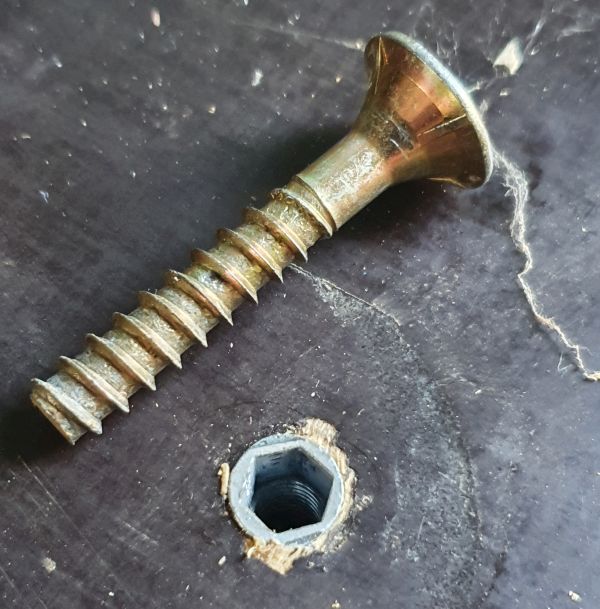

Hi @timothyleong , the picture you attached shows the nut part way up the bolt used to drive the Insert in.
I hope that at the time you drove the Insert in, the nut was screwed down to engage the top of the insert.  That would be essential for this method to work.
As for removing it, If you get a grip (spanner) on the head of that bolt and then tighten the nut against the Insert (& washer), it should all become as one and then be able to be wound out by turning the bolt head.
You may have to retighten the nut as it comes out, if it works loose, maybe even keep a spanner on it to keep it tight as you go.
--- I may have misinterpreted your query - is it the bolt that you wish to remove, not the Insert?
That may be as @Noyade stated, that the bolt has broke the thread. If that is the case, I would still try the method I've stated to  remove the Insert, as it won't be usable anyway if the thread has stripped.

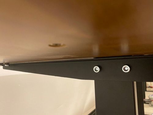

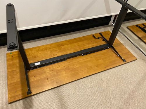

Hi guys, I managed to fit the inserts. Looks like this: 
So I have 2 questions:
1) I still have one hole where I drilled too small. Can I use a step bit to enlarge the hole?
2) And also in the last picture there is a bit of a gap between the legs and the table. I think its because the inserts are not flushed enough into the table. It looks quite stable at the moment. Should I try to screw them into the table somemore?
Thanks again for all your help!
Re: How to drill screw inserts in D.I.Y. table?
Hello @timothyleong
Thank you very much for posting photos of your adjustable table project. In regards to the smaller hole that you've drilled into the table, it is still possible to drill a bigger one. I suggest measuring how deep the hole is and marking the drill bit with a bit of tape so that you don't drill past the depth of the hole. Getting the next size up in your drill bit kit should be ok, but please remember to measure the item you are putting into the bigger hole.
In regards to the gap between the table, if the table is stable and there is no tipping in any of the corners, I propose leaving it alone. At this point, repeated disassembly and re-installation might not be good for your table's fixings.
