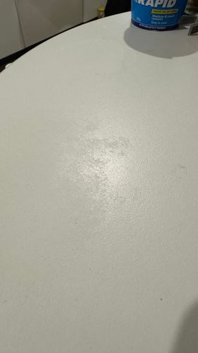

Re: How to fix a scratch on paritcle board table?
As you can see, the part with the lower sheen is the area I painted with the two paints above, do I need a paint with higher sheen or a glossier one?
Hello @Hayaimi
The repair looks great, I can't even see where you patched the table. I recommend not painting it any further as any additional paint will make it stand out.

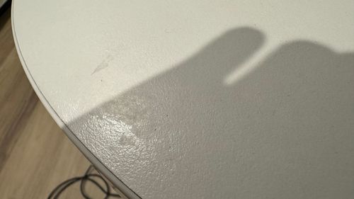

As you can see the sheen difference is obvious.
