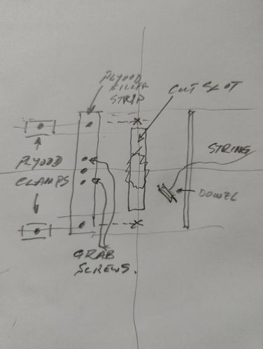

That's quite a bit of damage with enough downward force to push the bottom of the curtain bracket into the plaster.
Wondering if you have kiddies and/or kitty's.
I suggest not to make the hole larger, instead cut a slot.
Cut a slot in the plaster.
Cut a larger piece of plywood
Drill a center hole for string to pass through
Also drill two screw pilot holes for the clamps.
Cut two smaller clamp pieces and drill pilot holes.
Position and align the plywood on the plaster and drill through the pilot holes to mark the plaster hole locations.
Drill out the plaster holes with a larger bit so it's easier to see them later on when mounting the clamps.
With dowel tied to the end pass the string through from the back.
Apply adhesive to the plywood strip, poke into the slot and pull back the string.
Use the grab screws to manoeuvre and align the plywood strip clamp pilot holes with the plaster holes.
Install the clamps and screw down.
Later on do the usual plasterboard repair thing after removing the clamps, the grab screws and cutting the string
Cheers

Thanks @AlanM52
Can I use this Ecoply 2400 x 1200mm 17mm Plywood Pine Structural CD Grade - Bunnings Australia? WOuld it sufficient to hang the rail hook?
Should I clean up the back of the plaster?
Hi @dogbural,
No need to spend that much.
18mm Timber Multi Use Pine Panel
https://www.bunnings.com.au/specrite-1200-x-600-x-18mm-timber-multi-use-pine-panel_p0419619
That will be fine, you only need to measure/cut a piece that will cover (overlap) all of the damaged wall.
Cheers
