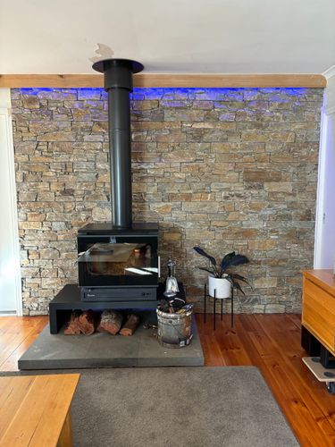

For the light itself, I highly recommend the Tapo/TP Link products. The app work very well as do all their products. I have lots of strip lights and smart plugs in my own home and just installed one in a stone wall pelmet. The strip light can be adjusted by the app to change colours and brightness and schedule on/off times. Also Google and Alexa compatible.

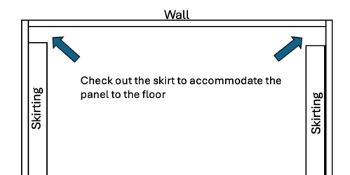

You seem like a detail person. How would you cut the bottom skirt to fit in the feature timber panel? See the diagram below showing a detail of the bottom skirt (top-down view). Given the timber slats is 21mm.

Hi @Yangaz what's the floor covering in that room, carpet or solid (timber, tile etc)?

Hi @Nailbag
The flooring is vinyl cladding.

Hi @Yangaz
There are a couple of articles worth a read on how to remove skirting. There is this one from a member post. And this one from Bunnings both worth watching.
The issue with prying the skiting from between the plasterboard wall and arc is that you will crush the plasterboard and inevitably go through it in places. This is not an issue when you're covering the wall and don't have to repair the wall.
When there is a solid floor I like to pry the skirting up so no wall damage the than scratches. Just protect the floor as you go. I still run a blade along the top painted edge and the corner mitre joins. The issue with prying outwards the skirting is the ends are within the mitre so you will need to cut them, which you need to do anyway as per below.
If you have a multitool you can use the blade to cut the mitre. If you don't have a multitool in your powertool collection and do a lot of DIY, then do yourself a favour and invest in one. I use mine all the time! The Multitool will also allow you to easily cut the rebates at the ends of the left and right skirting to accomodate the panel.

Morning @Yangaz
To add to ways I have removed skirting board without breaking it and doing too bad a job on the wall :surprised:
- I used a wide plaster spatula and tapped it down between wall and skirt, then I could get a larger wide flatblade screwdriver between them so I didnt leaver into a small spot but the force was spread out over the plaster. I started in the middle of the wall and worked my way to the corners much like a foot one side of the halfway mark then the other then back to the first side. The piece could be pulled out like a bannana if I took it slowly.
Since you are putting the soundproofing down to the floor you could cut off the very ends of the skirt or leave them as they will be covered (with a little trim) in case you one day want to put the skirt back.
