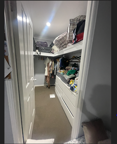

Following is the picture where I want to lay Hybrid flooring
Yes, there is a door that opens to WIR.

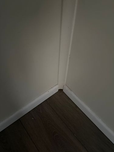

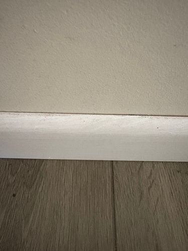

Do I have to remove existing skirting and give some gap between flooring and vertical wall for expansion and contraction ? or, can I give a gap between flooring and the existing skirting, and use some small trim (not sure exact name) ? I have seen them using in my friends place, long, think stick to hide the corners.
Re: How to lay hybrid flooring in wardrobe?
Hi @Sugar
Yes, you can leave the skirting on and use timber moulding to cover the gap of the hybrid flooring. They are also known as Hanwood 2.4m Scotia Ash WPC Hybrid Flooring Trim, they come in various colours so please choose carefully.

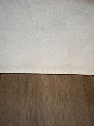

Hi @Sugar we removed skirting/trim and layed ours down with a little gap when meets the wall and then nailed a new skirting/trim down so it sat on top of flooring to hide gap. But I have seen done what it sounds like your friends have done.
This is inside bottom of cupboards we built for now. I haven’t cleaned for a while lol  
Just make sure you cut right length or ends up gappy like ours..luckily we will be fixing it by end of year as putting cupboards along that wall. lol 
