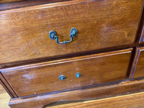

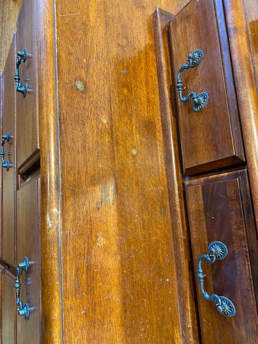

 hi, how can I fix the paint for my dressing table? As you can see in the pictures there’s many different colour spots

What a beautiful-looking dressing table. I can already imagine what it will look like once it is restored. Are you planning to upcycle this dresser or keep its original finish? Our first step is to remove the handles and check the cabinet for integrity. Are the drawers still in good condition? Is the overall frame of the cabinet still firm? If any repairs need to be made to the dresser it will have to be done before we begin the restoration work.
If the cabinet is in good condition, we need an area where we can sand the cabinet where it will be safe from the elements. I suggest using an Ozito 200W Detail Sander. It has multiple sanding pads for furniture restoration. Once the dresser has been sanded, wipe it down with a clean cloth and use a vacuum to suck any remaining sawdust. I recommend using the UNi-PRO 18 x 36" Painters Tack Cloth for the final clean.
Before choosing a finish for your dresser I suggest going to your local store to look at the varnish display in the paint department. There you will see the different finishes and stains that are on offer. A good example of a stain and varnish is Cabot's 1L Walnut Satin Water Based Stain And Varnish. It is a water-based varnish giving you a much faster drying time and easy cleanup. Please remember to test the varnish in a small hidden area of your dresser to see if are agreeable with it. It sounds like a fantastic project, we would love to see any updates you can provide while restoring the dresser.

You can get different levels of gloss as well as pre-tinted colours and the paint desk can also tint a larger range of colours.
I would sand first to see if those light spots will blend in before deciding on a finish. Light stains can have problems covering differences in colour that darker stains may cover more easily. Prooftint can be used to help cover problem areas before applying varnish.

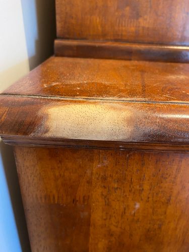

 thank you for your help, I’ve sanded a corner of the dressing table and this is the original colour of it, do u reckon I can use a light coloured varnish, if yes what colour do you recommend?

Thank you for the update and for showing us the actual timber colour of the dresser. I suggest testing Cabot's 1L Water Based Gloss Cabothane Clear Polyurethane Timber Varnish. This is actually a clear varnish, but as you know timber reacts in its own manner when it becomes wet. I suggest visiting your local store and look at the varnish display board in the paint department. I recommend water-based varnish as it does not turn yellow like oil-based varnish.
