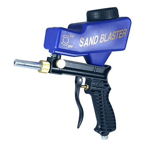

“However” there is a method that will strip it all back in no time, your going to need a sand blasting set up, but you do not use sand or glass bead you use bicarb soda (baking soda) and it will give you a perfect job. No damage to the base material.
here is a cheap and easy method (home made)  in video 1 and I am sure you good people at bunnings can provide something like the second video.
The blaster can be obtained from Amazon. Most of all there are no chemicals no hard work sanding plus baking soda is safe for the environment
I have completed some research as to where you could a system $50 from supercheap
