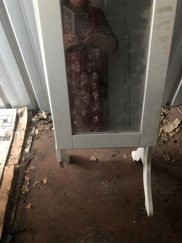

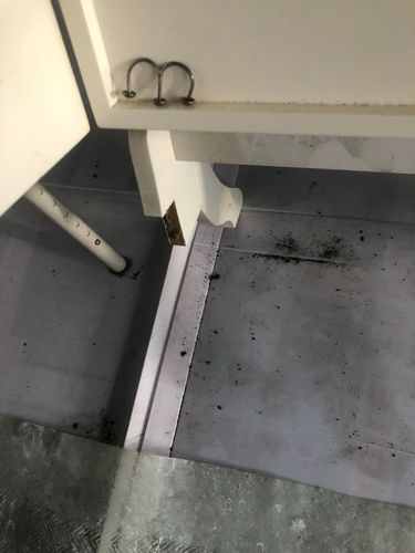

How would i go about fixing this cabinet?
brendawebster44
Experienced Contributor
I was given this mirror because I was soo nice. That’s what you get for being nice.Any help would be appreciated or it goes on the tip b🌺

@brendawebster44  Hi Brenda, do you have the missing piece from the broken leg? If so you should be able to re-attach it to the main part of the leg.
If the piece is indeed missing you could lay the cupboard over on its right hand side and trace the outline of the good leg onto a cardboard template so that you can replicate the missing piece of timber and re-attach it using a couple of 100mm x 10 gauge screws
As you like the cupboard it would be worthwhile trying to fix it rather than sending it to land fill.  If you don't have the tools or practical skills to do it yourself maybe you could contact the local Men's Shed for assistance.  They are usually very helpful and are 'tooled up' to make or repair just about anything.

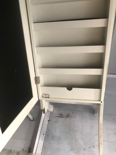

hi do you have the missing part? as suggested it is an easy repair providing you have the tooling. could you provide a better photo of the section where the leg is to attach to please.
also if you do not have tooling or the skills to to the job the as suggested the local mens shed / community shed should be able to help.
what state / suburb are you in and i may be able to direct you to a local shed.

Hello @brendawebster44
It's great that you've received fantastic suggestions from @Walzz and @r23on. I totally agree with their recommendations on how to repair the legs of your mirror cabinet. However, if you are feeling adventurous, have a look at your tools and see if you can find a Trojan 165mm Coping Saw. A coping saw allows you to make specially shaped cuts on timber.
I won't lie to you, it will take time to cut that shape out by hand. That's why going to the local Men's Shed will make this repair much faster. They will probably have the tools necessary to replicate the foot of your cabinet.
