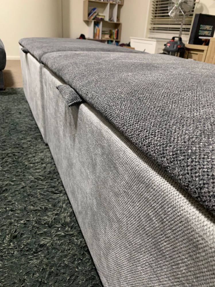

Our previous couch had an ottoman that will fit well with it forming a bed for us to relax and watch movie nights. We were missing it with the new couch. So I decided to build two with storage.

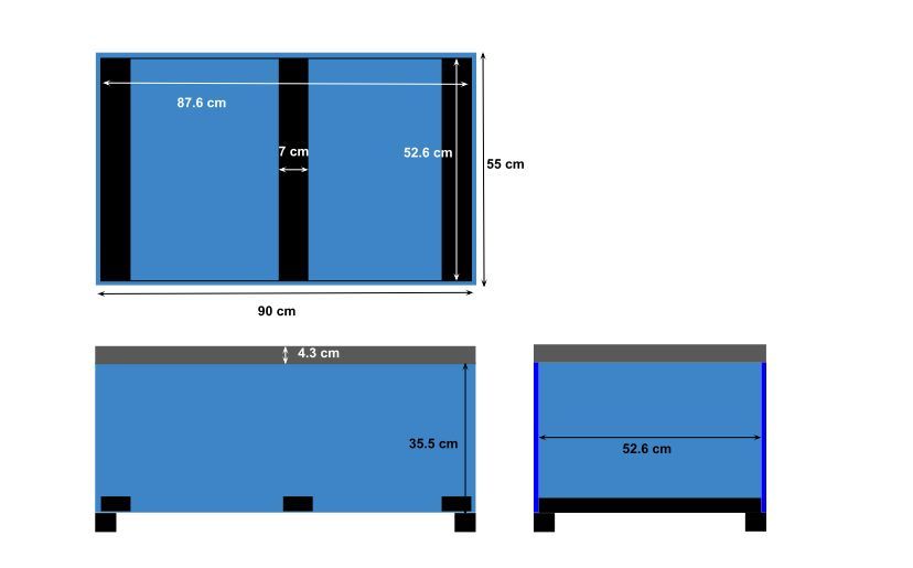

Plan Plan Plan. You should calculate all lengths, where what will land, how it will look in front, back and side
Step 2

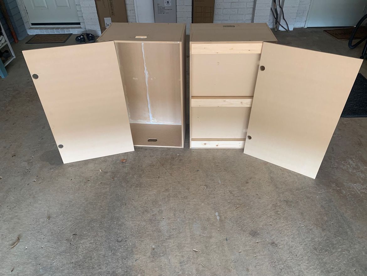

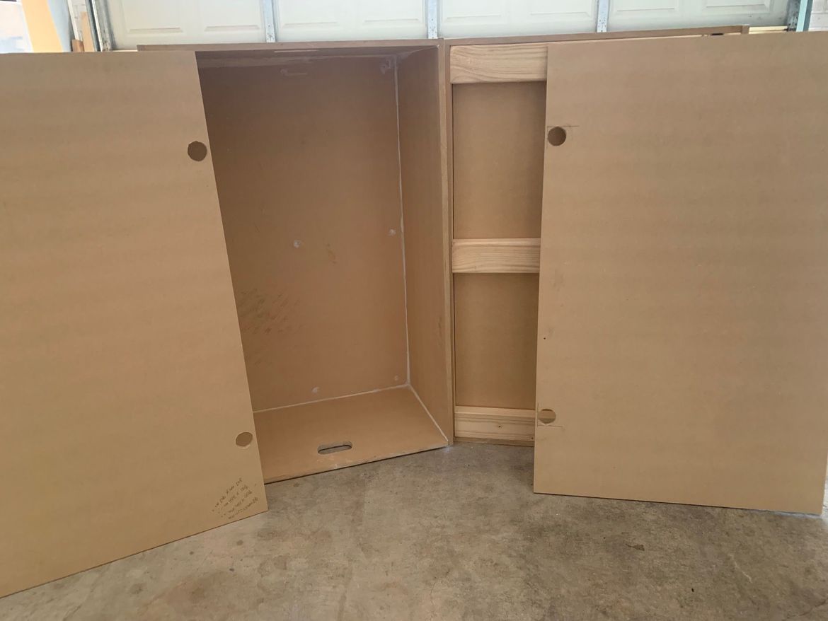

Start by assembling the box. Put three framig timber on the bottom for structural integrity. 2 people can comfortably sit on this ottoman. Drill holes for hinges in the top peice.
Step 3

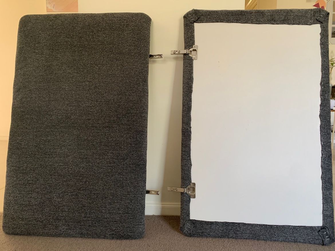

Paint the inside. You can choose to cover it with fabric as well. Put foam, polyester fill (to get a smooth finish) and cloth. Start stapling. There are several videos in you tube on how to get a smooth finish. Install hinges
Step 4

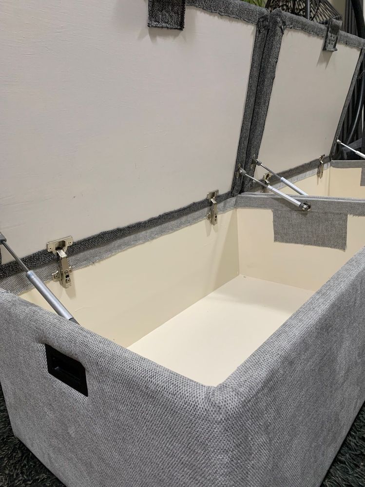

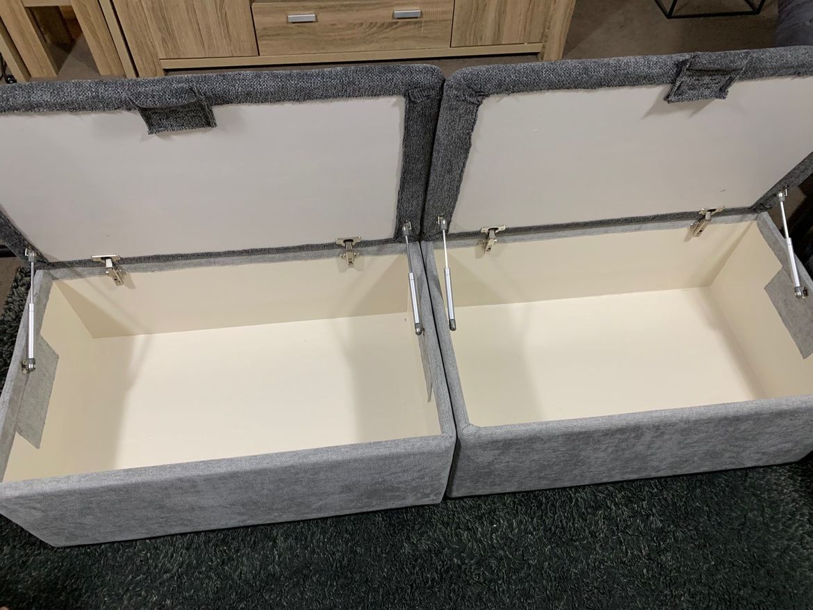

I sewed the sides to create a sleeve. Inserted the sleeve into the box. Took some elbow grease to get a tight fit. Staple top and bottom. Using same fabric, stitched a small handle and stapled it as well. Added gas struts for easy opening and closing.
Re: Ottomon with storage
Fantastic job on your ottoman project @J-P. It looks really well-made and practical too. The addition of storage and gas struts is a clever touch, and the upholstered finish gives it a polished, professional look. A great way to combine comfort and functionality.
