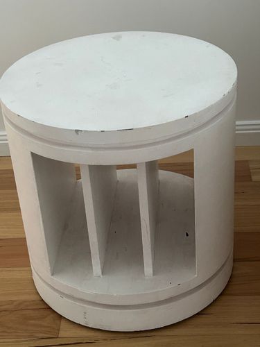

I took a round coffee table/magazine rack and added a new top using a SpecRite Round Timber Pine Panel to the top.

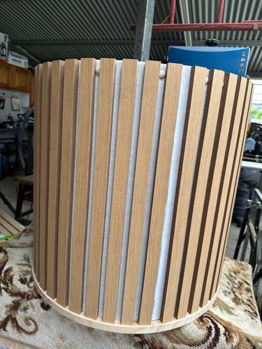

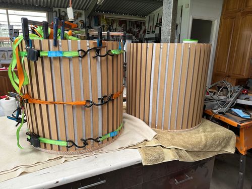

I cut SpecRite Timber Slat Panels in 600mm lengths and secured the top and bottom with tech screws. I then applied Selleys Fast Grab Liquid Nails to the walls of the coffee table and progressively wrapped and screwed the panels around the coffee table. I also used quick action clamps to secure the panel as I moved around the coffee table. Finally I used Ratchet Straps to hold the panels until the Liquid Nails set.

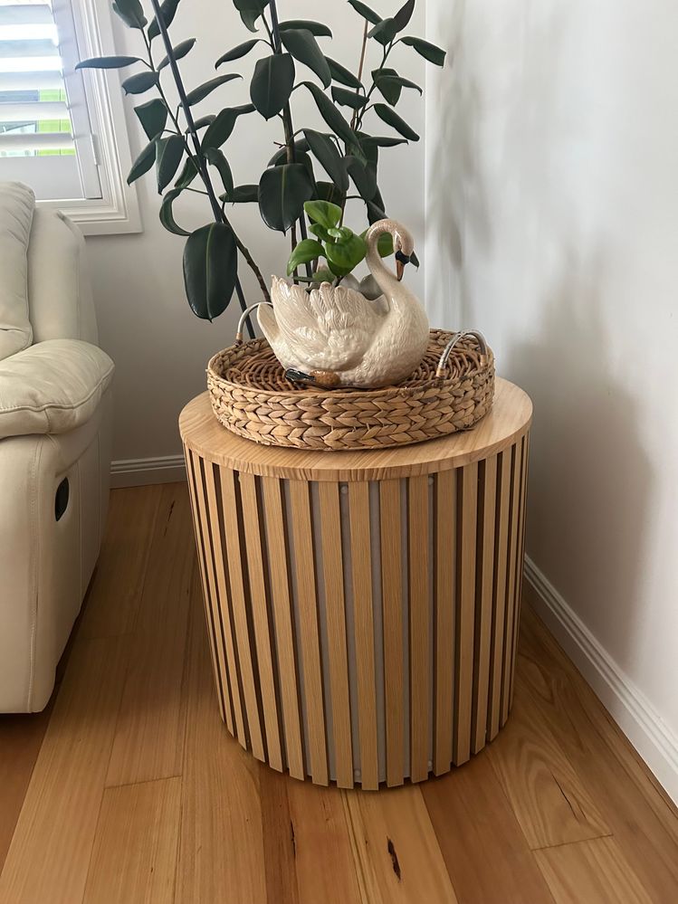

Once the panels had been secured I then added Taskmaster 10mm White Screw Caps to all screws.

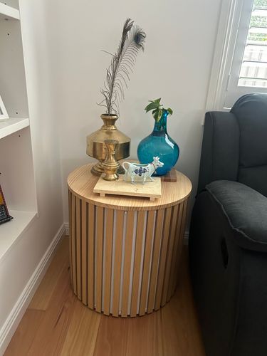

Finished Project.

The transformation of your mobile coffee table is truly impressive. The use of SpecRite Prempanel Timber Slat Panels in Oak has given it a modern and refined appearance, beautifully complementing the natural tones of your flooring. What was once a basic and dated piece now looks like a stylish, high-end side table. It’s a fantastic example of how thoughtful material choice and craftsmanship can completely refresh and elevate a space.
