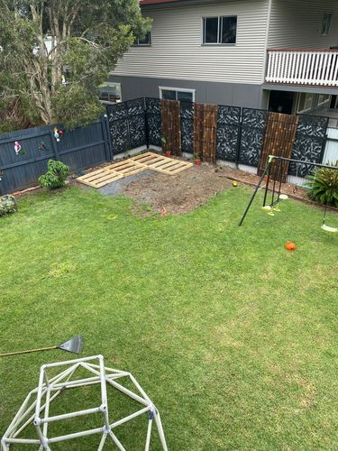

So this was what we started with, and this is where we are at. I’m building the deck using the 3.34 x 3.34 modular decking kits Bunnings sells. We are trying to create a peaceful corner in the garden to be able to sit and relax and watch our son play.
as you can see, the third far right bamboo screen is not yet attached. I am not sure why the other two attached easily and this one is being so painful. I will get longer screws tomorrow and see if that’s the problem otherwise I may need to attach a wooden frame to the fence instead to drill into rather than the metal.
