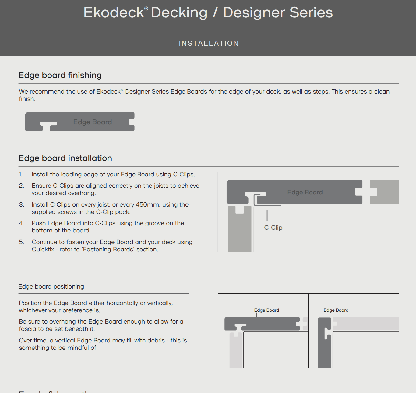

Hi team, I was building this over the past couple of weeks, about to complete it. Now for the finer details, what spray paint colour will best match the Ekodeck leatherwood ? I am planning to spray paint some screws to top fix the last row of board.
Re: How to build low-floating deck using pedestal feet?
You didn't want to, or can't, use an edge board, @simont? Seems a shame to face fix the last board.
You could use something like this Dulux 300g Metalshield Epoxy Enamel Gloss Spray Paint in Mission Brown, though the screw heads will be solid brown and still quite noticeable against the grain of the board.
