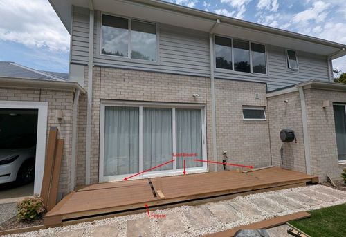

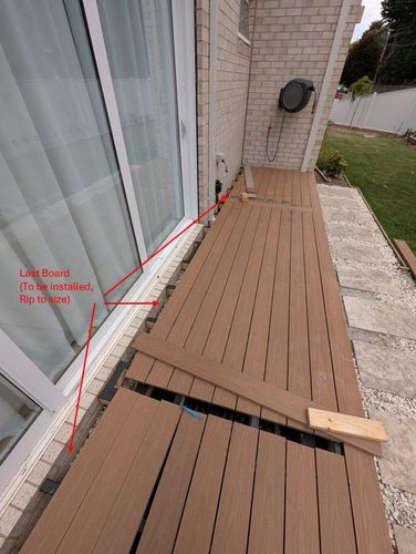

Thanks @MitchellMc .
I do use the Edge Board for the board furthest from the house wall.
What I meant by the 'last board' is the board closest to the house wall. This is the board I need to rip to size, and unless I’m mistaken, the only way to fix it is by top-fixing. Is that correct, or is there a better method that avoids top-fixing altogether?
While we’re on the topic, I understand the fascia board will also need to be face-fixed. Is there any way to install it without visible face fixings?
I’ve attached some photos, hopefully they provide the necessary context. (Please ignore the fascia installed in the photos, those are just temporary off-cuts and will be removed.)

Hi @simont,
Face fixing that last edge board is the simplest and easiest way to do it and with a bit of paint, the screws wouldn't be too noticable.
In saying this, you could refashion the groove, which would allow you to use a C-clip, but this would require a router, a specialised bit and some careful planning to ensure it lines up correctly. I wouldn't call it a beginner skill, but it is possible.
Unfortunately, with the fascia board, there is no way that I'm aware of to avoid a face fixing on one edge of the board because of the way the C-clips are screwed in place. If you are using an edge board, I would but the C-clip in the groove on the back of the board and then screw in the bottom edge. Having one row of screws low down to the ground won't be too noticable.
