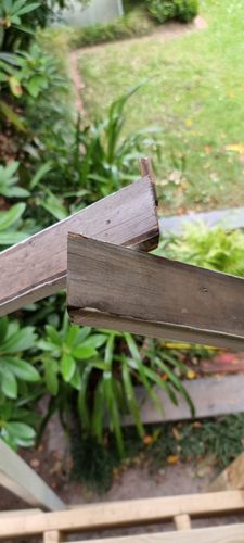

A separate question for you, the fascia boards on the front of the cubby house where the apex of the roof meets, I found that as the joints are at an angle, there was an embedded piece of plastic that joins the mitre, do you know where I can source a replacement from?
My colleague @MitchellMc is on a well-deserved break. As to the plastic angle was there a specific size you needed? There are plastic angles such as Siniat 20 x 2400mm PVC Capping Angle Plaster Trim. However, if you need them to be wider you can use galvanized zinc angles or flashing tape if you're trying to seal a gap.
@EricL not quite what I was after. It is actually a piece of plastic that slots into the timber to create a join where you can't nail securely etc. Looks like glue holds it together.
Would it be like the plastic "H" piece in panel joins? Just to be safe, would it be possible for you to post a photo of the plastic piece? If you can also include its size and thickness that would be great.
Would it be something like this - Wall Art Joiners 2400mm Snow White Sheet/Panel Joiner?

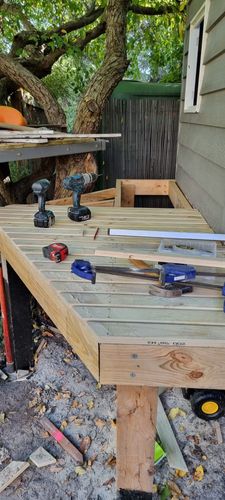

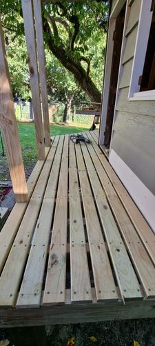

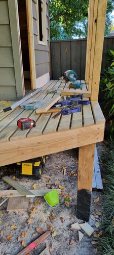

@MitchellMc some further pictures of progress. Ran out of decking boards so need to purchase some more and then to fit off the verandah and build the steps.
I love it @globetrotter!
I see you went to the effort of installing that additional post on the corner I recommended. Great decision. This really is a tidy build, and you should be exceptionally proud of what you've achieved so far. I'm excited to see your finished results.
I'll be keen to see if @EricL has seen that joining piece before, as I haven't come across them. However, I'll do some investigating.
Many thanks for these updates. They really help to paint the entire picture.
OK, I'm back after educating myself. Those appear to be something called a Hoffman key. It's a proprietary system and requires a machine or specific router bit to create the corresponding dovetail channel they slip into. Unless you are particularly passionate about going with that method, I'd recommend ripping down a length of timber with corresponding sides to the angle at which those boards are meeting. This can be used underneath them to provide something to screw into.
@MitchellMc OK you're unreal. I couldn't find anything - maybe I need to improve my Google search skills :-).
Totally unpassionate about retaining that method, I just wanted to make sure those two angles could be secured so I was extra careful not to break it but in the end I did break a portion of it. Thanks for the simpler suggestion.

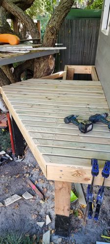

@MitchellMc I thought I'd share a few more pictures. Stairs is the last part. Any recommendations on building one? Seen a lot of YouTube videos. Happy Easter.
