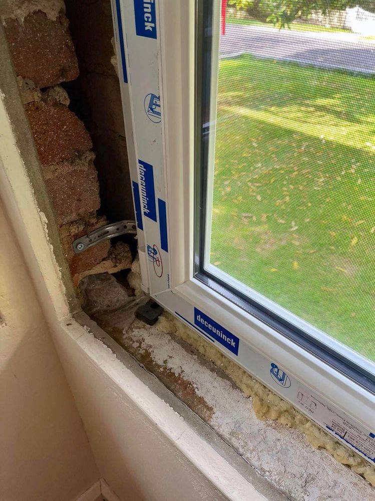

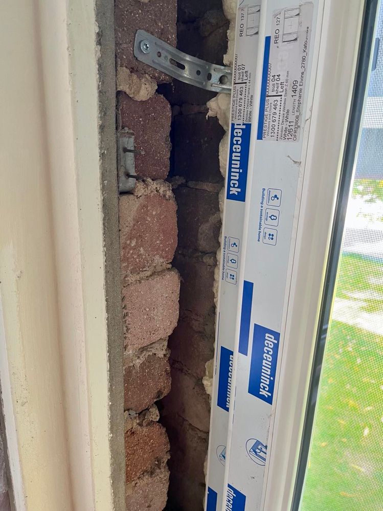

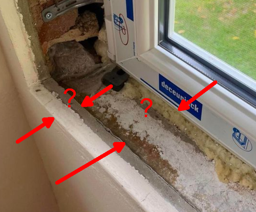

hey guys - i've been here asking a few related questions and some of the helpful answers are now leading me to this question.
I had new PVC windows fitted but i refused to have any timber surrounds.
After browsing the internet, most suggestions are to use plasterboard - But now it has been pointed out that any moisture resting on the plasterboard is not healthy so i would like to ask for advice on what i should use/do?
There are also suggestions to use insulated cavity closers, but i cant see how i would fit them as the windows are attached to the outside wall (double-brick). I don't want to use wood anywhere - Can i use PVC or something moisture resistant instead of the plasterboard?
As always, your help is massively appreciated and my hurting head will be forever thankful ๐๐๐

Hey Jacob Re the wood - we live in the blue mountains and want to avoid the possibility of termites as much as possible and also maintenance - The previous architraves were a sight to behold and a lot of timber, some of which had shown signs previously of termites and rotting.

Nice idea - i'm still concerned about whether there is a possibility of damp coming thru the plaster. I have seen this in the past but only occurred to me now i have to do it myself ๐ค The other thing is i really just want a plaster - look around the whole window, so no wooden sill, at all. It seems a lot of youtubers go with plaster-board all round but my concern is still the damp - i have no experience on what happens if i do use plasterboard everywhere and should i be concerned about the damp? still confused about that ๐
Afternoon @elbow
I am not particulary worried about vertical surfaces with moisture, just window sills/door ways ect that have the potential of water sitting on a flat surface.
Garage lining for stud walls stage 1 step 3 shows how I have put plaster up to edges on brickwork but always have timber on the bottom. I have attached plaster directly to brick to save space and its still there 3ish years later ![]()
As to the look around the window you could still do with timber/timber pieces, you could source thnner timber (12mm) and paint it the same so it looks like plaster but has a better stand up to water. Just remember youtubes showcase perfect stuff, generally they dont show what happens down the path. I get my ideas from them
